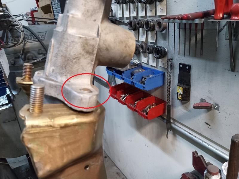

Since I cannot use the existing Z-bar I will need to mount a hydraulic master to operate the Howe hydraulic throw out bearing.
This is a pain in the ass with a vacuum booster so I will fit the car with a manual master.
I did some research before and it boils down to this. The Mopar minivan master will work but requires the ears to have the holes moved outboard quite a bit. Best match is a 1" bore, while the Mopar unit has a 24mm (0.94") bore.
We refitted a friend of mine's 68 FB with a 1969 type front disc and retained the stock drum manual master (1" bore). It worked very well. I looked at several masters - selecting the 1974-80 1/2 ton truck manual master. These come with a deep pocket for the push rod.
Unfortunately the later aluminum/plastic units do not; the rod is held with a rubber boot that does not seem to be available anywhere. Note how the manual master has the recess (1) for the boot - the power unit does not (2).

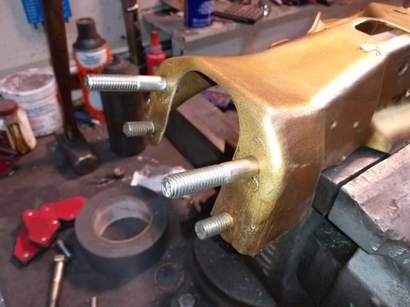

I went to test fit the larger aluminum master and noted this: the studs are too short
Then I realized I needed to trim them years ago to make the power booster mount easier to attach. Dammit.
So the panel brace will have to come out and the studs reworked. One just popped out, the second really put up a fight.
Eventually the second one came out and new stainless bolts were welded into place. Not as nice as I would have liked but will work quite well.
