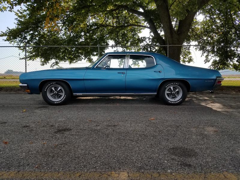

These are HM 15x7's on my Lemans.
Dennis
Dennis
They look good! Thanks, that's very helpful.
Dennis
What size tires?
  #59

Originally Posted by 79 Phoenix View Post
What size tires?
225/70R15's (27.07" tall)
