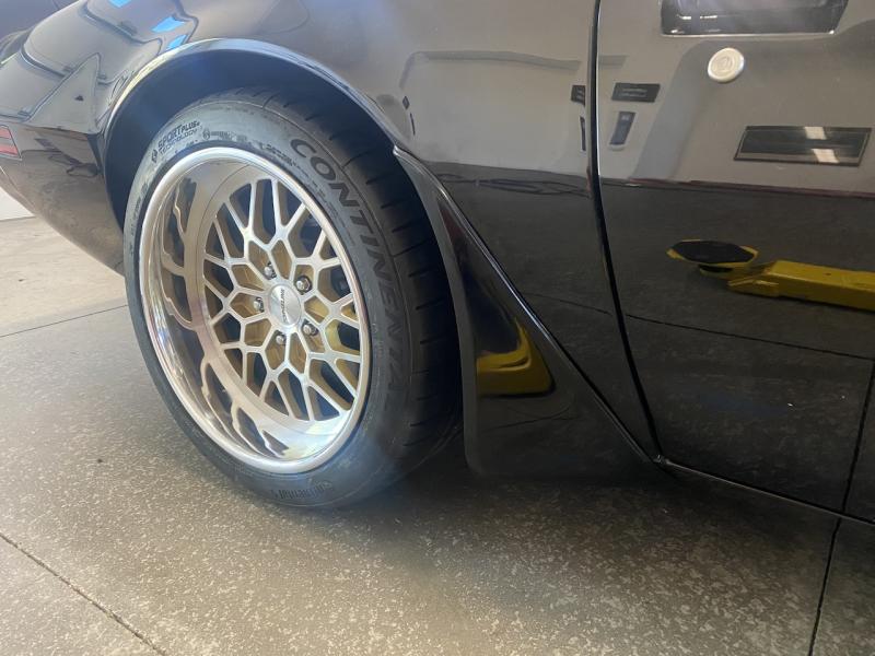

Also installed wheel flares.They were the originals, and fit well. The welting needed some adjustment where it folds over at the top, but not too bad for our first time doing this. We used 3m trim and emblem adhesive.
