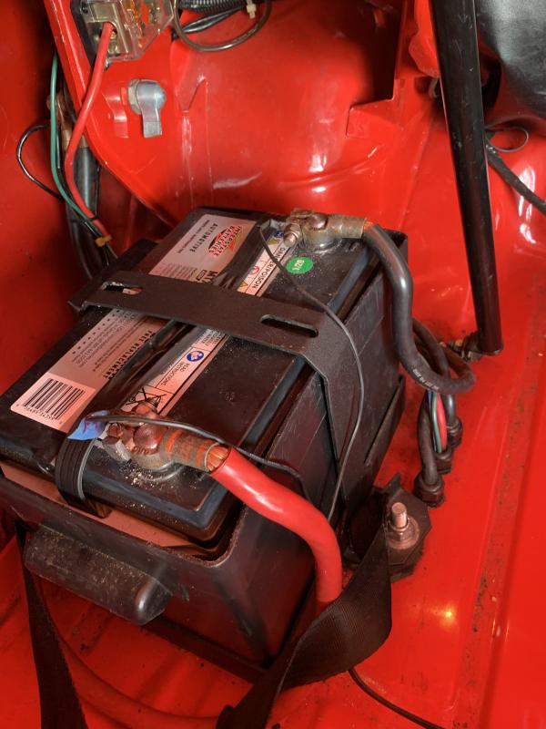

Here are some photos to better explain above. The third photo shows the cut off switch and the black box hanging off the battery box is the remote solenoid. The plastic box is a power connection for the stereo sub-woofer.
The last photo shows the ground to frame connection (since removed, wire brushed to extreme shininess and put back together with new dedicated 2/0 cable ground also attached.

Bill Hanlon's advice solved the problem. With the Orbit Orange Judge sold, attention was turned to the red Judge convertible. Armed with my trusty voltmeter I found the following:
Voltage across battery terminals 13.1 v
Battery pos to near side of neg cut-off switch 13.1 v
Battery pos to far side of neg cut-off switch and frame 13.0 v
Batt neg to input side of trunk mounted starter solenoid 13.1 v
Batt neg to output (to starter) side of solenoid when cranking 8.9 volts!
Now we're onto something.
Since the battery is in the trunk, the start wire from ignition switch, through 50 year old wiring and the neutral start safety switch to solenoid was reading only 7.8 volts instead of 12.
With the solenoid getting lower voltage, the contacts were not closing completely and the output to the starter was miserable. Just to make sure I jumped a wire from the battery pos to the solenoid and presto - 12.9 volts out to the starter. Problem found! I had previously tested the mini starter and it tested perfect.
I then fabricated a relay using the blue wire from the ignition switch to activate the relay and connected the relay input to the battery positive side of the solenoid and the output to the solenoid "I" terminal.
I am overjoyed to report that any and all hot start problems are solved. I never got to remove the heat blanket on the starter. Now I can't make it hesitate on hot starting and she cranks in all situations like the proverbial banshee (a supernatural female spirit in Scottish folklore known for her high pitched wail. Also a Pontiac concept car from 1964 that was decades ahead of its time. I got to see it once in an old barn here in Florida).
Life is good and I'm driving the heck out of her now.
