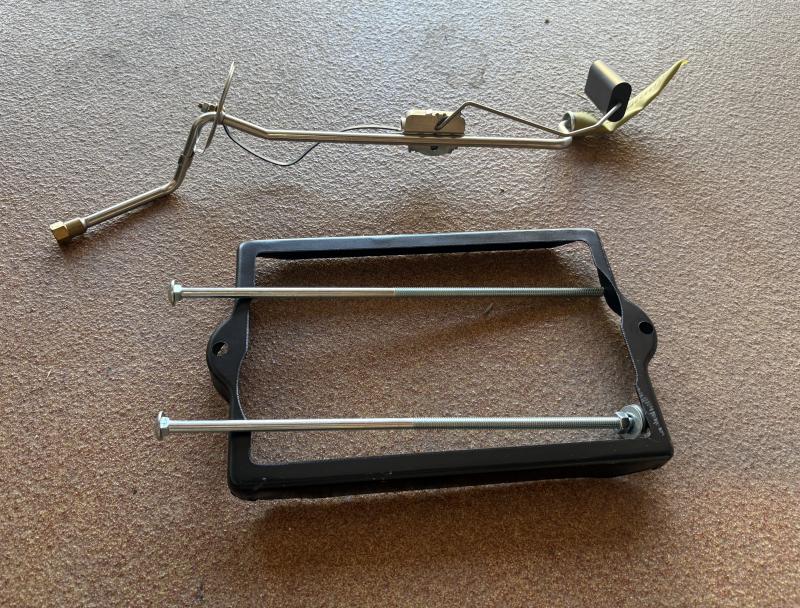

Today was another Package Day! Got the sending unit and a battery clamp kit from CPR, and installed the sending unit. There was some gunk left in the tank, so I did my best to knock out what I could. The new unit went in pretty easily, and looks great.

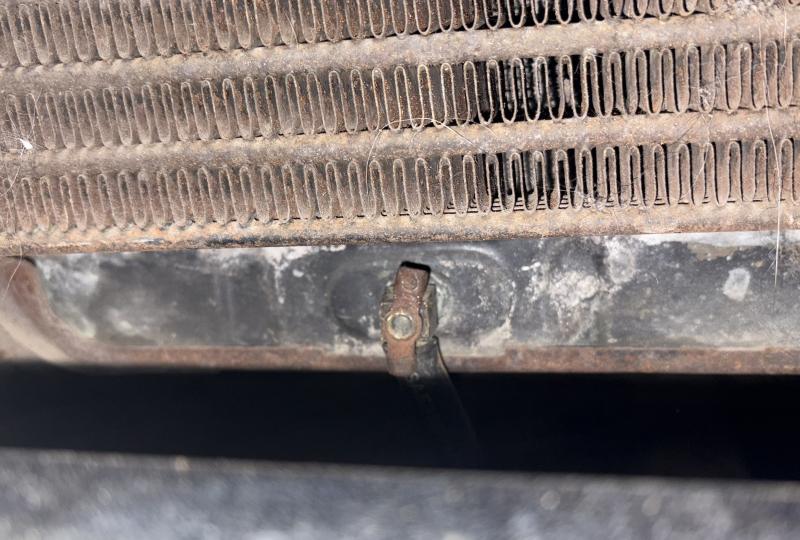

The radiator, however, is another story, and has me flummoxed. I crawled under the car to try to access the drain cocks on each side of the engine, only to find that they didn't exist! It looks like they have been replaced by set screws, for some reason, though I could be mistaken. Maybe the cock snapped off? Visibility isn't the best under there. Next, I looked at the radiator drain cock, which existed correctly. When I tried to open it, however, the wings spun without actually opening the drain valve - so something is stripped. I expect I'll have to replace all those. Fortunately, Ames seems to have the right thing. https://www.amesperf.com/parts/14042/

1. I tried to remove the entire petcock from the radiator, but I couldn't get it to budge with the poor leverage I had. Am I going to have to take the front bumper off to get proper leverage? Any other advice on removing and replacing all the petcocks/whatever's stopping the holes in the engine?

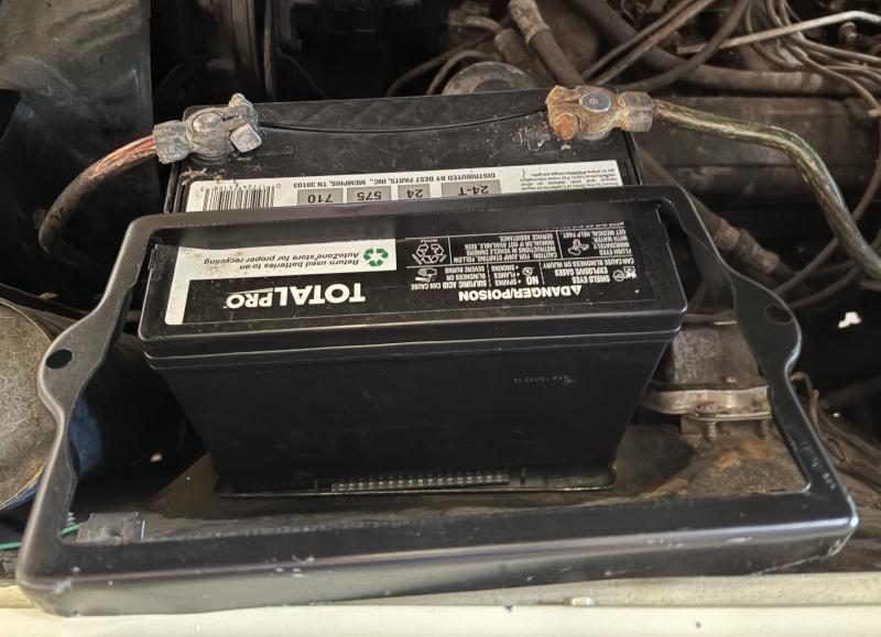

2. Give me a sanity check here. Picture below for reference - it looks like the battery holder will do nothing but short the battery when I install the cables. Am I crazy, or is there something I need to do?
It isn't unusual for the wing on the petcock to go bad and spin without doing anything. Replace the petcock if you can. I don't know what it looks like there with your AC radiator. Can you unbolt the evaporator in front of it and move it out a bit to get a bit more room to access the petcock?
I think that is the same battery hold-down I got from CPR and it works fine, but is a loose fit on my battery. I don't think battery connections will touch it once installed (I could be wrong of course). For original correct battery hold-down with straps attached to fender, see photos from Rich Gabrielson's Safari. The correct version is hard to find, I've been looking.

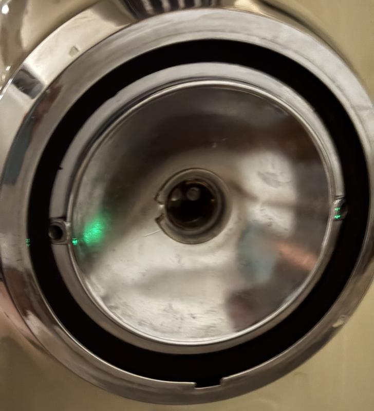

Another package day today, I got all the indicator gaskets from Ames. The front indicator and the reversing light gaskets were actually cork (that's a blast from the past), and the taillight gaskets were foam. I thoroughly cleaned the reversing lights (parking lights were done last week) and installed all the gaskets. Now the reversing lenses don't rattle in their frames.

For the plugs in the block, do start with a lotta lube. You might try the impact drill. Best would be to heat the block around the plug with a torch and then try to remove it -- if you can. But that might be difficult to do. Be safe, have a fire extinguisher handy.
