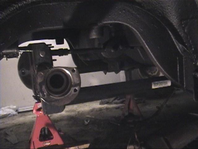

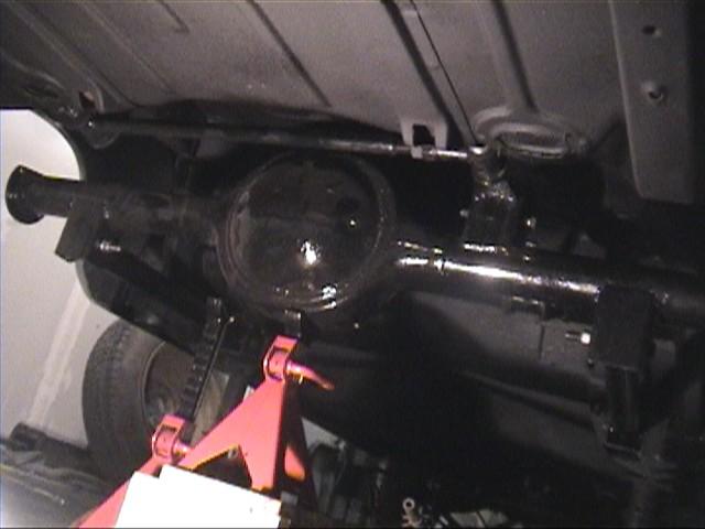

Just though you guys might be interested in my latest indevor on my '61. Here are a few pics of the mock up phase and the final install of an 8' Ford diff. I fabricated the trailing arms myself (using Autocad) and purchased a poly bushing kit for 64-72 GM A-body. This is a three link set-up with panhard bar. The diff is about 3" narrower than the swing axle. I have a set of 7" steelies that I am using for mock up. I will likely go to an 8" rim and a 245-255 low profile tire. I am moving to the front next. I have a Mustang2 front suspension setup with power rack that I am thinking to install.

Had some trouble with the posting. Here goes again.

And a passenger side view of the new

And a shot from the rear.

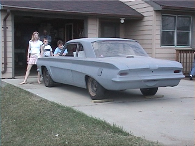

that is close to how I did mine in 1964.I hope you have room for a full length coil spring.I did not and the car road like crap.The last 3 I have done have coil overs and rides much better.Tom

I debated on spring configs but I am going to go with a coil over setup also. I am going to use my lower trailing arm mounts for the lower connection and a crossmember between the rails at the top. I designed in enough clearance between the panhard bar and axle for a 3-1/2 coil diameter. At ride height the top of the axle will be 5-1/2" below the frame. I plan on putting a snubber there (similar to the front lower control arm stop). This should give me about 3-4" jounce. That should be plenty of distance and provide sound ride.
Tom, what are you using for spring rate in the back for an "acceptable" quality ride?? If anyone has a good set of coil overs they want to part with let me know... I am still shopping for them.
Below is a current picture of the car (and my kids). I put a 2x6 between the frame and axle to get a good look at ride height thus far. I have not done anything to the front yet but cut the coils.
