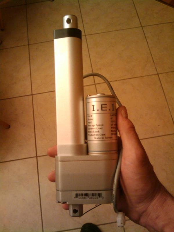

Received this 12 volt linear actuator in the mail today. I'm going to see if I can use this to open and close the hideaway doors on my 68 GTO. It has a 4 inch shaft that extends out when 12 volts is supplied. Reversing the voltage causes the shaft to retract. I should be able to accomplish this with a couple of relays. My car already has a rod connecting the two door levers together where somebody hooked up a mechanical style lever to open and close the doors, so I only need one actuator. Just need to figure out the mounting of the actuator behind the grille.
Attachment 216547
Did a test fit and a quick hookup of the electric actuator to see if it is strong enough to open and close both doors. I'd say phase one was a success. Here's a quick video I just shot with my cell phone.

Originally Posted by 369GTO View Post
What applicastion was the actuator from so I can look for one? Also, how dod you wire it? Thanks Jim [email protected]
This was the actuator I used.
https://www.surpluscenter.com/item.a...577-4&catname=
I also purchased the mount for it.
Right now, I am using a double pole toggle switch to operate the opening and closing of the doors. The wiring diagram comes with the actuator. Eventually I will incorporate it into the headlight switch using a couple of relays.
