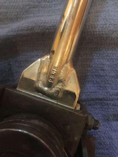

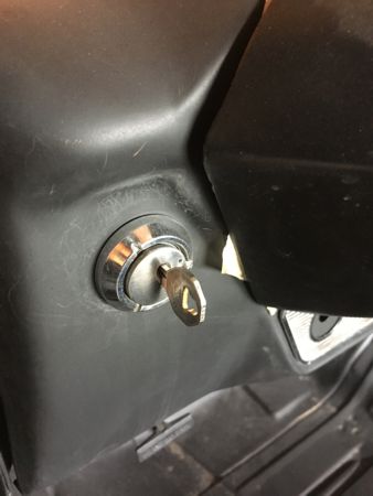

Still plugging away on my project doing little things mostly right now. I am waiting on an opening with the body-man to do a couple more things that are above my skill-level (fitting the quarter extensions and fit a badly depressed spot in the roof).
Thanks to John V.'s pictures on page 2 of this thread - I was able to recognize and grab this nice 3-speed shift knob....
I also had a local locksmith cut me an ignition key based on the PHS docs, so now I finally have a key for the car...
I turned the key...but it turns out I still have a lot of work ahead.

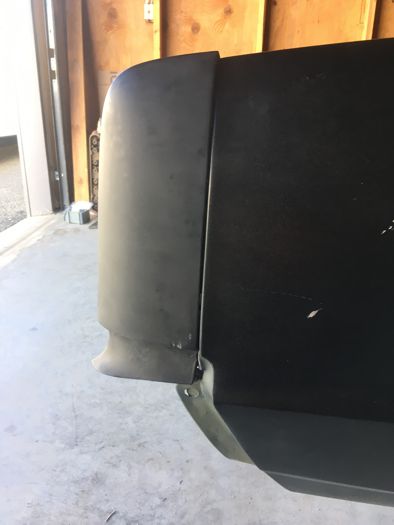

Hi Everyone...
I figured it was time for a little update on my progress with the '64. As you may known from previous posts - I had an AMD quarter panel installed on this car when my salvage quarter turned out to be in tougher shape than it looked. I mentioned briefly that we were pretty disappointed in the fit of the AMD part at the rear of the panel. At the time we didn't pursue fixing it since we didn't have the deck lid that we intended to use (among other things).
Recently we got the car back over to Cam at Imperial Kustom in Boise to address this issue and make a fix to a problem with the roof (more on that later). I have to say that this kind of metal work is so far above my head that it seems like magic to me - but WOW the things a person like Cam can do.
Here are a couple of photos to show how ugly the fit was at the rear...
The solution was to graft a portion of my unused salvage panel to the AMD quarter and to slit the quarter to move the panel up and over. Here is a look at that work...
Continued in the next post so I can keep the photos together...

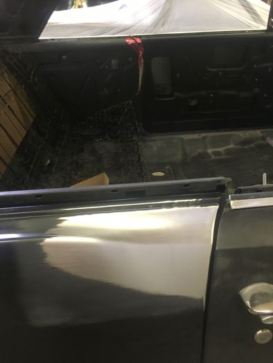

Continuing from my last post...Here is a look at the almost completed reworking of the AMD quarter panel...
In addition to the problems at the rear of the quarter the body line that picks up at the rear of the door and become the top of the quarter was really weak.
A little dolly work brought that line up to a good level of "crispness"
I can't tell you how pleased I am with this work and the progress. Hopefully we can address just a couple more areas and then I can take back over doing the bodywork tasks that I can handle.

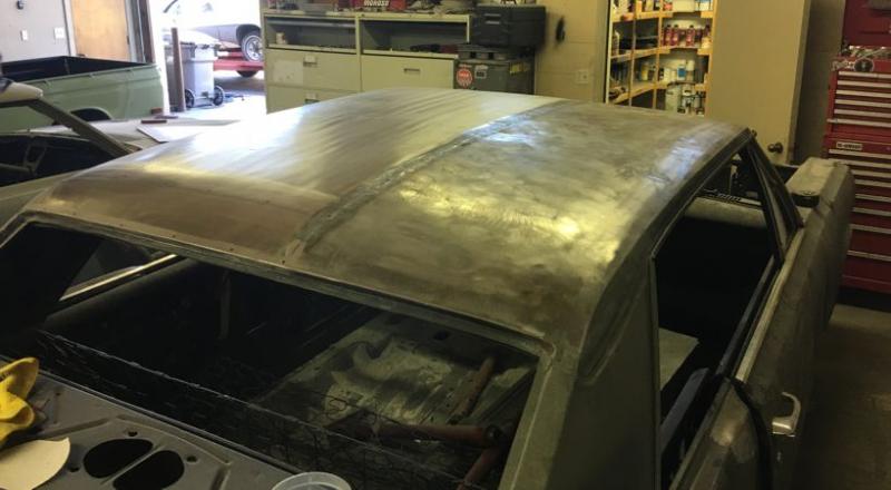

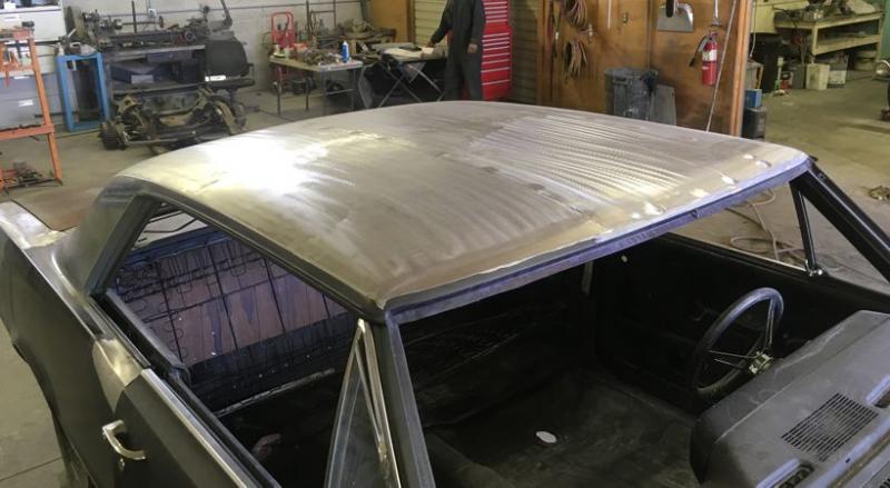

Hi Everyone - I thought some of you might enjoy an update.
So as I mentioned in my last post - in addition to the quarter panel fit issues - the car had a pretty messed up roof.
I don't know what happened to damage the roof initially - but the bodywork that was done to it was a crime. At the deepest point there was about 2" of bondo, and the whole roof turned out to be a sculpture constructed of filler.
The first thought was to replace about 1/3 of the roof and straighten the rest of the bad area. Unfortunately, the roof metal was really stretched and oilcanning badly with the weight of the filler off it.
As I'm sure everyone here knows roof skins in good condition are really difficult to find, and I've had a couple of hard lessons about internet parts and their condition.
So my guy said he would make the roof with his english wheel and stretcher. And he did.
Here is what the initial fit-up looked like...
More in the next post...

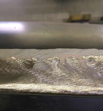

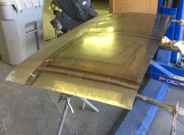

Once the fit-up with the panel off the car was good enough, then the hard work of welding it in place and straightening the remaining portions of the original roof began.
Here it is at that about that stage...all the seams are gas welded except for those around the perimeter which were MIG welded since there is no access behind them to planish the weld.
After the welding some final hammer and dolly work brought the two panels into shape and agreement with each other.
In the tradition of the workers on these cars of the past - he included a little graffiti...I am truly amazed by the level of craftsmanship displayed in this roof.
This work was so far over my head (pun intended - I just couldn't resist) that I frankly am in shock. Thanks for following along.
