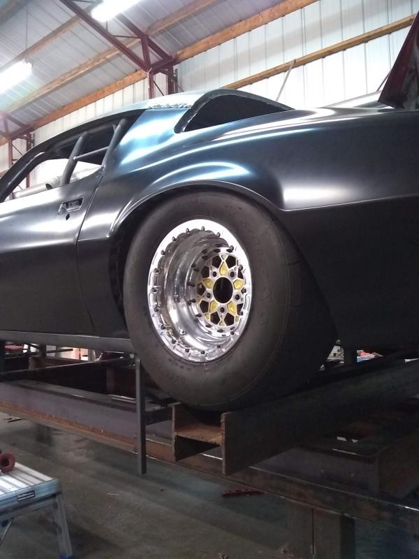

More body panel tweeking and setting up rear wheels and tires for flange to flange measurement so we can calculate the Fab 9" housing dimensions. Thanks to Ray Cox for the awesome wheels! Picking up the rotating assembly in the morning. I'll post shortblock assembly pics over the next couple of days. Stay tuned.
ID:	536868   Click image for larger version
ID:	536869   Click image for larger version

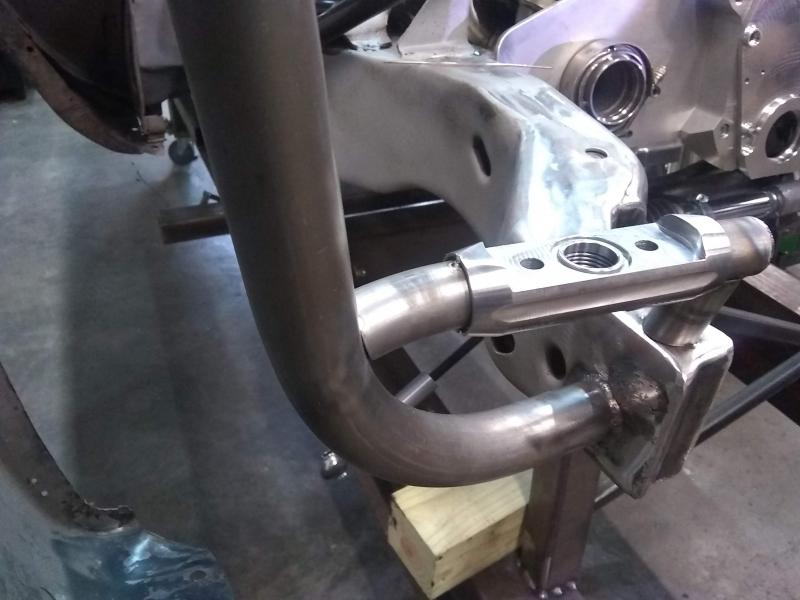

Default Hot side
Hot side fab begins with finding a location for the VS Racing 78/76 T4 turbos. Nick found some awesome turbo mounts from Maven Performance and welded them to our core support "in progress". Then he had to lengthen the driver's side log manifold to protrude through the motor plate like the passenger side log. Then proceeded to run 2.5" stainless to the turbos from there.

Could you post up a few more detailed pictures of how you will have the oil drains for the turbos plumbed?
