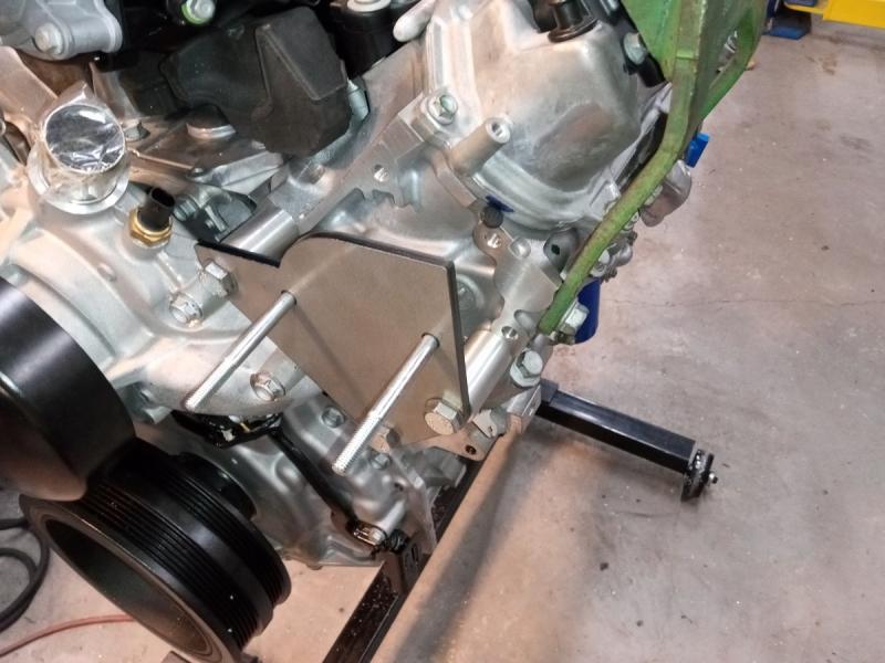

This is the first prototype bracket. The next version will lower the pump 3/4" for better radiator hose clearance.
This is the initial setup. The pump is 1998-02 F but will take the 1997-05 Corvette unit also.
The tensioner and idler are GM parts. The LT motors do not have them - I wonder if the alternator simply pivots and is used to tension the belt - kind of an overcenter thing? I will try it with the newer version once it is cut.

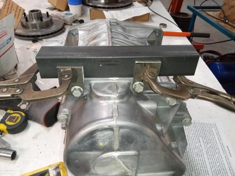

Work has been insane lately trying to keep up. Today I had a bit of time so decided to pop the motor in with the harness loose and then decide where what needs to go. The harness and programmed ECU was supplied by SwapTime out of Las Vegas.
As you see it is quite roomy in the back - the trans/engine split line is as stock. The mounts work superbly - went right in as designed.
I cannot attach the file here, but anyone who wishes them I will send to, then you can have them cut.

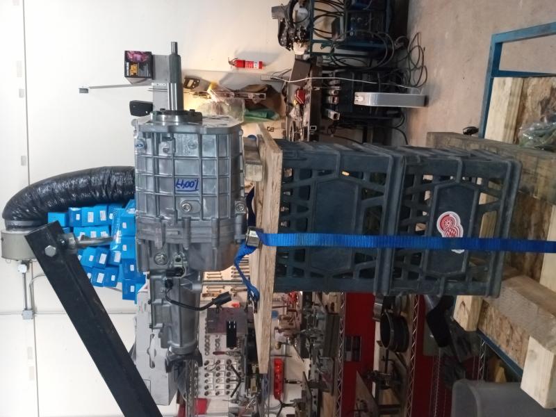

More time today. I decided to stab in the trans to check fitment and gear up to fab the crossmember mounts. One thing that always bugged me was transmissions are never flat on the bottom - always rolling about. I flipped the TKX on it's top and took a hard look. I noted that 2 of the lower bolts could be made to hold a "base" so to speak, so a few minutes of fab work and this is what I got:
Sits on some stacked milk crates atop a rolly cart just fine - quite stable. I ran the vehicle lift all the way up,then laid the trans on it and rolled it under the car - then lowered the car. Slid in perfectly - hopefully she is just as trampy when the clutch and other components are in place.
I was able to reuse the stock trans support and mounts - fit in perfectly,
The rear mount will need a 1/2 - 3/4" shim to get to the proper driveline angle and one corner of the shifter porch will need a quick visit from the singlejack to clear the shifter mount.
All in all not a bad day, though the shifter shows signs of being a real bugger. Hurst makes a shifter called the Sidewinder that would have solved this but requires machining to the tailhousing to work.

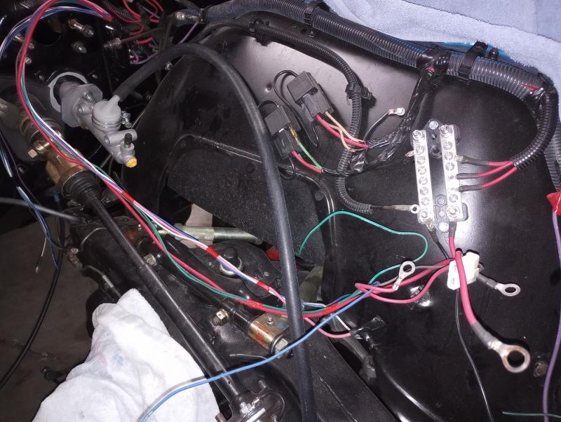

Last month worked on sorting out the wiring harness while the engine is out.
Swap Time did a decent job but definitely room for improvement. Note once again this motor is a pretty new architecture that is kinda slow to catch on as far as I can see.
I cleaned up the wiring a bit, made a bracket to retain the harness under the front of the oil pan. The drawings are available for the asking. The OEM 2014-19 harness guide does not match the 2020 motor so it was trimmed back to fit better. I also will incorporate a couple extra wires in the harness for stuff like oil sender feed as I am running steam gauges currently.

Time to clean up the driver's inner fender. While practical I did not like the kluge the headlight relays and busses presented. The battery is now in the trunk so this stuff will go behind the LH head light core support area.
Other extraneous wiring will go away too.
