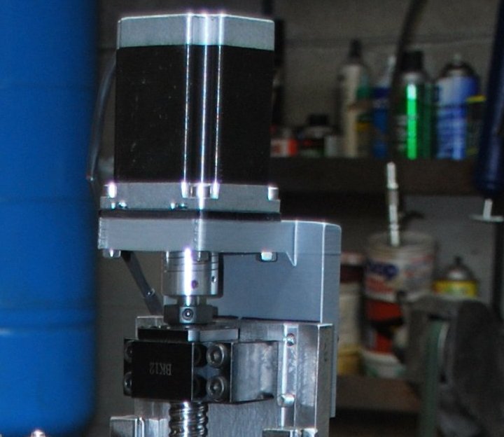

Very cool. Looks like you are into race cars? I so wish I had this printer when I was building vintage race bikes ... jeez it could have saved me some time and money coming up with small to medium pieces like that.
So far I'll typical go with four walls thick, or 100% infill on things that need to be tapped, has worked great.
Are those PLA or PETG? I was amazed at the strength of these parts when printed right, previously I was under the impression everything would be pretty fragile.
Printed this NEMA 23 motor mount for my CNC project out of PLA with I think 50% infill, four walls. A bit of warping in that corner as I forgot to cover the HVAC vent that blows right on the printer, printed at 70mm/second and 0.35mm layer height .. so I was pushing things a bit. Turned out very strong and perfectly usable. Also printed up a 1/8" isolation spacer out of black TPU.

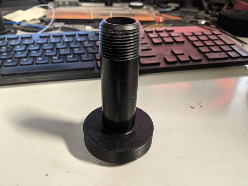

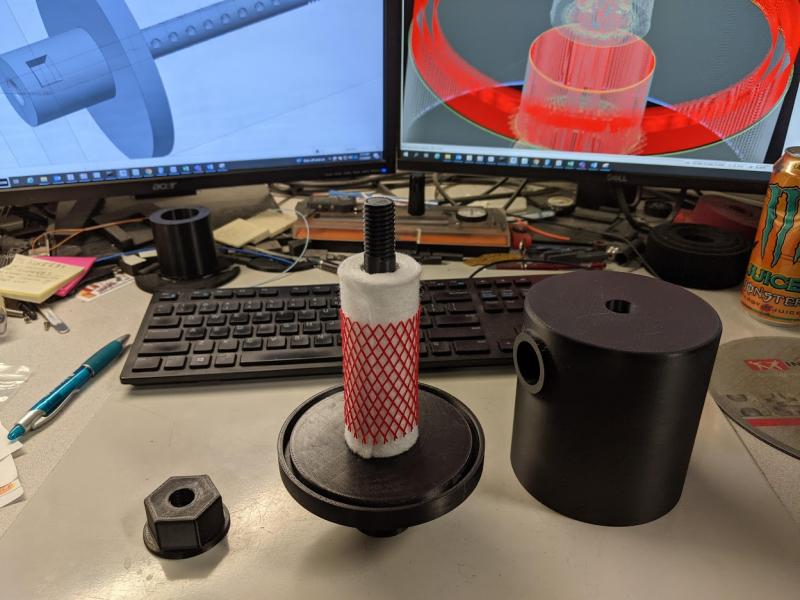

I modeled and printed this filter assembly yesterday. It has 5/8-11 thread and 7/8-14 NPT modeled and printed.
ID:	605069   Click image for larger version

Very nice, my first attempt at threads was just printing straight from a cad file, 3/8 - 16 ... worked OK after being hit with tap and die. I didn't make any allowances in the file for the fact they were being printed.
Do you make any modifications to the thread profile for printing? I know some people will cut down the point of the threads to a small flat.
Do you recall the layer height you used on those prints? Nozzle size, material? Sorry for the questions but it's great to have the numbers to go along with the photos to get a fell for this process.
For the helical sweeps, I just sketched an equilateral triangle with s=pitch on the outer diameter of a extruded shaft for the male thread and the inner wall of the nut. That's not a true thread shape, as you mentioned (the point should be trimmed by h/4 and form a trapezoid) but I wanted max thread engagement, and the resolution of the machine is a limitation on the definition anyway.
Layer height was .007", T12 Nozzle, and ASA material.
