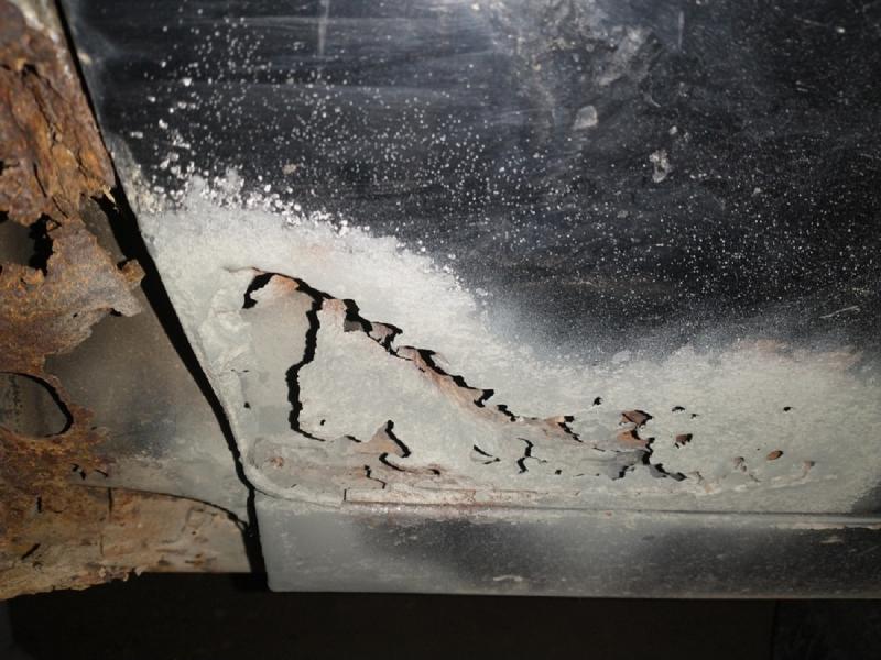

While I'm working on the underside, I am trying to figure out what to do with my drivers door. Just the crimped area of lower corner remains and it's rusted to the point of broken on lower horizontal part. There is a door I have found that I'm sure has been repaired that I am considering but it's primer covered and I dont know what's under the primer... ANY THOUGHTS OR SUGGESTIONS?

well, it looks like (from the third attached picture) that the primered door will need repairs to the backing structure like yours;
since it’s loose, you could look inside to see if more rot is there, and “repair work” has been hidden by the primer.

Got a new door! My current door lower front corner is actually used up. Nothing to repair without fabricating a new corner which is beyond my skill level. So I got a really great deal on a new driver's door... I needed to buy both front doors to get the deal so I have a pretty nice passenger door which I will probably sell. Here is picture of old door corner and new door. New door needs some work but it's something I can do myself...

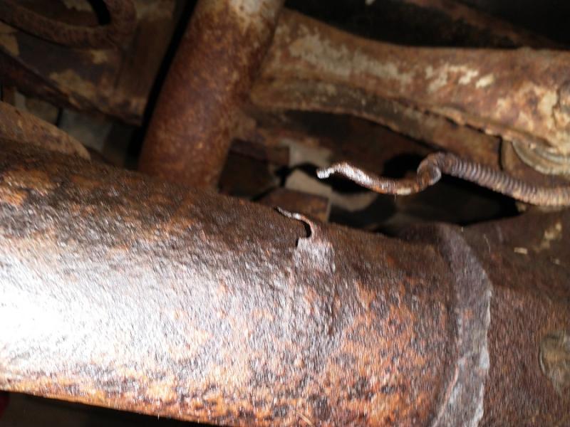

Also, On the rear end housing, these brake line clips are probably going to brake off when I try to use them again because they are sooo rusty... Is there a solution other than welding on new clips?
