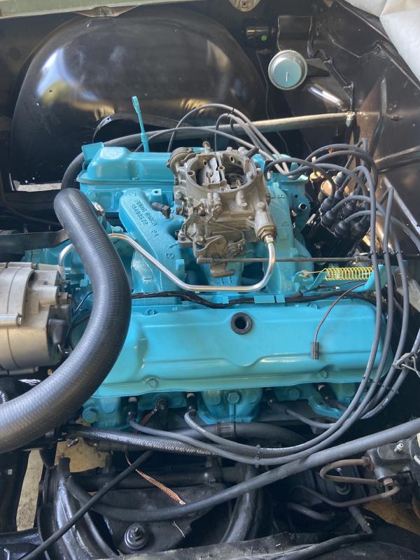

Even sideways that looks like an awesome 1965 Bonneville, how lucky you are to inherit such a fine machine. The entire Pontiac lineup won Car of The Year in 1965.
I do love the car it’s been part of my whole life.

Beautiful job on your 1965 389, looks like it just rolled off the assembly line right there.
Did you do a 100% stock rebuild, or did you perhaps lower the compression ratio a little to compensate for today’s lower octane fuels ?
Lower compression 10 to 1, 068 cam, Autotec pistons from Ractec, Scat connecting rods, alot of the internals came from Butler. Block, crank and heads are stock. Yes I’m going for a stock appearance. The heads required some work to install push rod guide plates because it had bad rocker alignment, that seems to be a thing with these 389 heads.

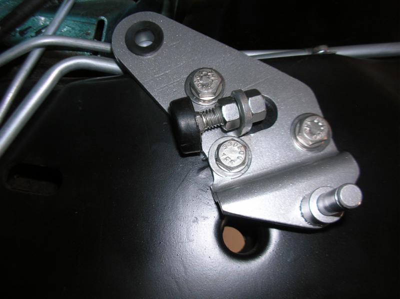

Picked up all the stuff I dropped of at the powder coater. It all should have been zinc plated but I got all my items coated for $60.00 including the frame mount for the clutch linkage and the two A/C lines. They made sure the swivel nuts on the ends still turned freely. Not correct, I know but for the price I'm not complaining. I have the correct zinc plated coil bracket in the second pic for reference.

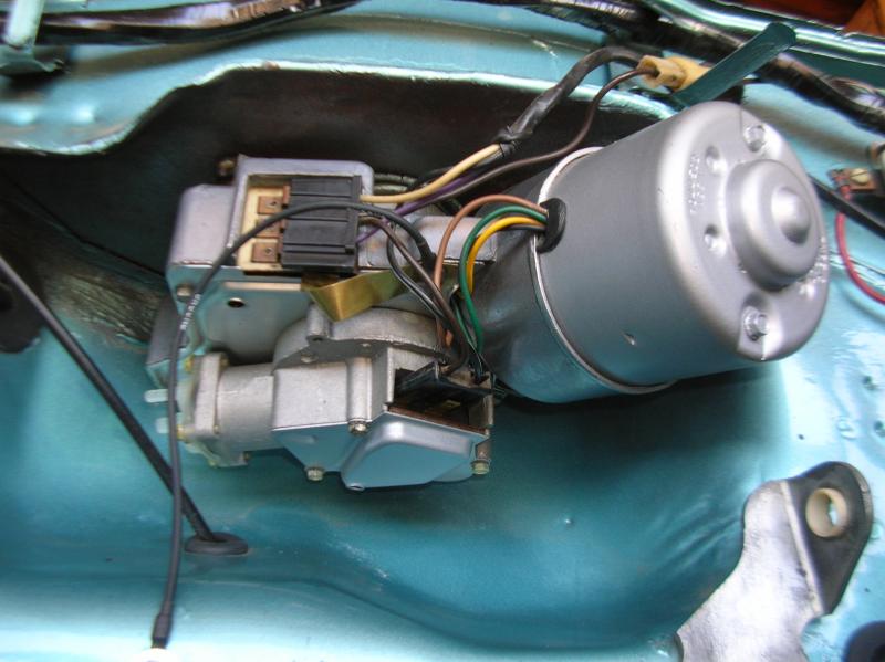

I also detailed & installed my 2 SPD wiper motor with a NOS washer pump only to find out the wiper motor wouldn't work. I'm an idiot! It worked fine when I parked the car 10+ years ago. Pulled it apart, the white grease was like gorilla glue Cleaned it all up and used a light coat of red grease. Works like a champ again.
