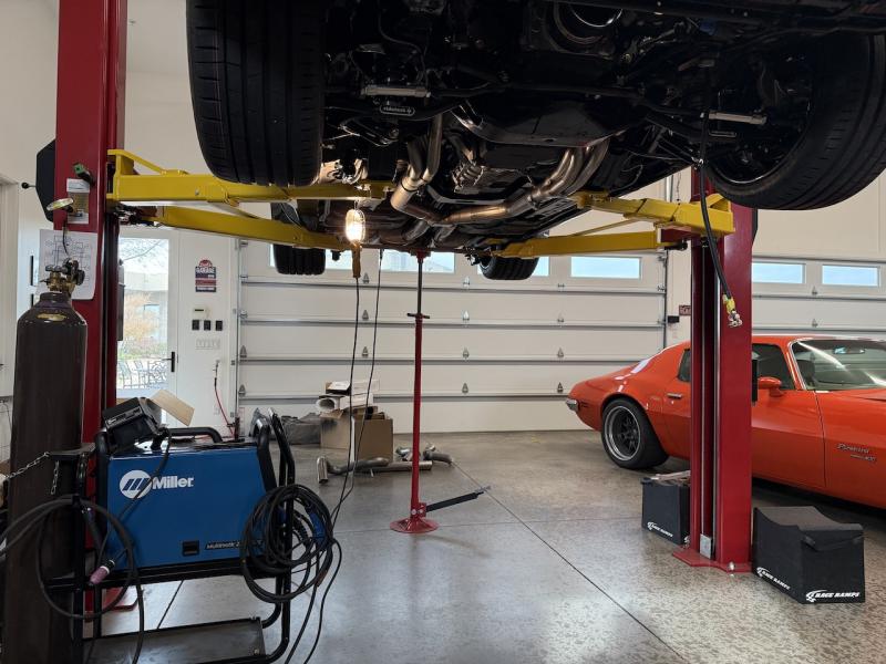

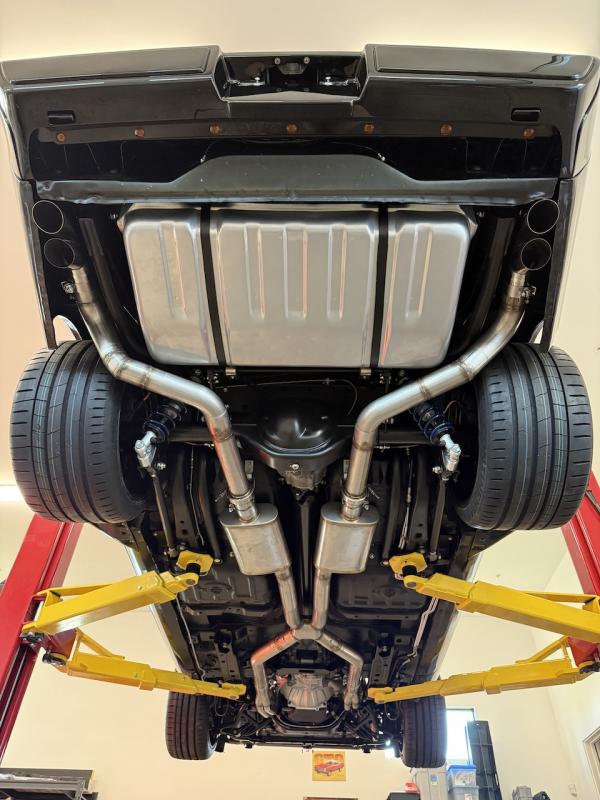

Exhaust is done. Also wired up the neutral safety switch, speed sensor, and reverse lights from the TKX, so the bottom of the car is finished (at least for now).
ID:	646399   Click image for larger version
