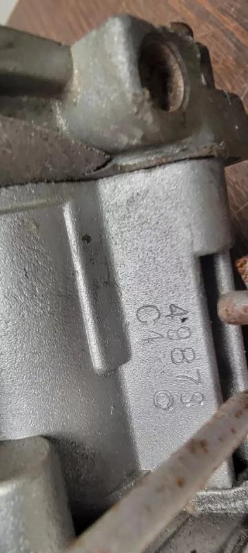

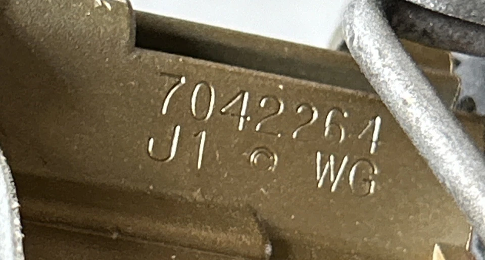

Both the Carter and Rochester QuadraJet's look very similar. OE will have a pick code (VB for the 7040264). Date wise Carter used a month/year (month=A to M, skipping I) whereas Rochester used a Julian date style (DAY/year, where day 001=Jan 1 to 365/366=Dec 31 depending on leap year).
Shown are two close to same build and a Carter replacement.
Your original carb. would have been dated in '69 probably.

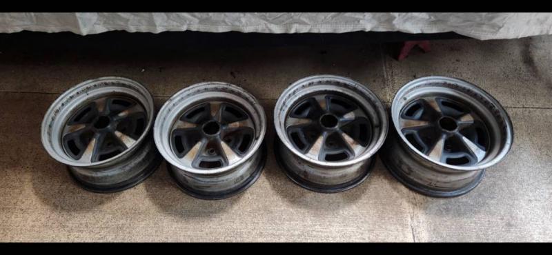

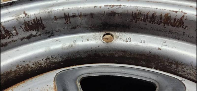

Here lately, my winter projects have been draggin into the spring & even summer, so i thought I'd get started on some this fall & get my buddy going with the sand blasting
They all 4 have matching codes
Dated
0 1 19
M1

Interesting. Those are correctly coded and dated wheels for your car, which is surprising since the window sticker didn't show that it came with Rally II wheels. Would be very difficult to find those if you went looking. I wonder if the dealer might have put them on when it was new because the buyer wanted them?
Did you ever check the tail filler panel to see if it was metal or fiberglass?

Yea, IDK.
I thought they were on the window sticker, but it only says chrome wheel trim rings & F70 x14 white ltr polyglass. You would think it would almost have to be a dealer install when it was brand new.

Going out on the limb a bit maybe ...
But your car was built so early it was probably dealer inventory ordered.
Would have had the small hubcaps with trim rings RWL
The guy who bought it probably had the dealer switch the wheels from another new car on the lot.
He bought it on Feb 27
If you had PHS Invoice it would tell what day it was finished / ready to ship to dealer.
But it's not really needed with what you already have.
If the wheels were per se' ordered after the fact for dealer to install - they would very likely post-date the car by a bit.
Main thing is you have them and they don't detract value or looks from the car at all.

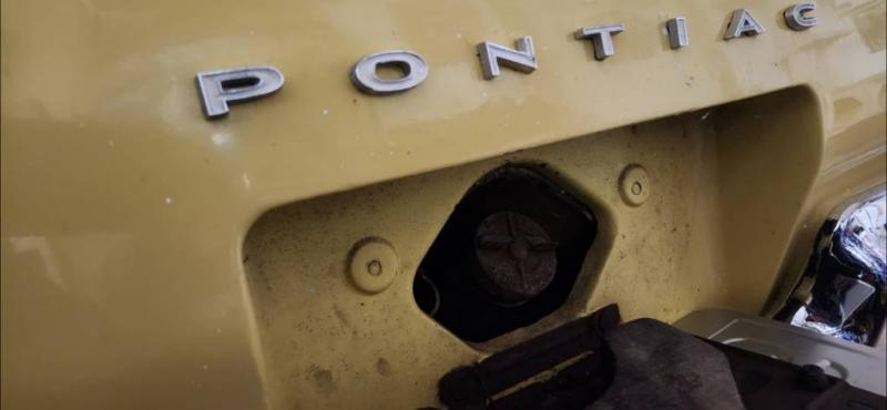

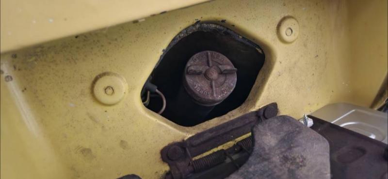

A magnet would stick to pot metal, right?
Magnet won't stick, & it looks fiberglass to me around the edges where the gas cap sits in thereClick image for larger version

Actually, no - a magnet will not stick to pot metal.
But if you see white fiberglass edges somewhere, that would be a tell. You might look up at the top of the opening where the license plate lamp mounts, too. Sometimes easier to see the edges there.

Don't see any white edges. Looks to be black under the yellow paint. The edges around where the license plate light is cut out, feel like plastic. IDK. If I was guessing, I'd say it's fiberglass Click image for larger version

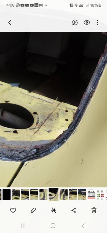

Also took the rear glass out to address the leaking window... Its not pretty, but I knew it wouldn't be. Found a place that makes replacement channels to weld in there. Plan on tackling this in the next couple weeks. Welding them in will mess up the paint back there, but i think its the best way to fix it "right" Paint has many flaws. Car has been repainted. It was close to needing the drivers side quarter & roof replacement. Crazy how much rot a leaking window can cause. Holes in the trunk pan from it tooClick image for larger version

Yes, that rear window channel rot is pretty common, especially with vinyl top cars like mine was. Totally rust free CA car except for that area. My body guy took care of it nicely!
