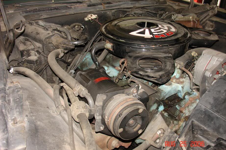

I didn't know that on the clamps having a tang on them, learn something new everyday! Here's a good shot of mine when I got it with what looks like the original hoses and clamps but after 37 years they may have been changed out. I think I can see the tang he is speaking of on the top forward hose in the pic :

Photobucket is blocked at my work, but I was able to use my iPhone to look at your picture posted above. That is definitely what I'm talking about. It's just a little L shaped piece of metal coming off the clamp. I think it is spot welded to the clamp. Not sure if it is used on all ends of all A/C hoses, but definitely some in the mix.
