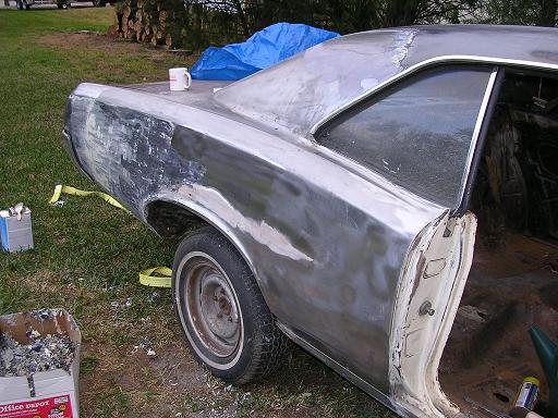

A few more pictures. I'm about halfway done with the paint stripping. Then the heavy artillery comes out (sandblaster).

Posts: 347
pic 2 Found 3 surprises on this side Bondo over a crease over the wheel well, bondo over the door on the roof and on the door where it meets the fender. None are deep and none seem to have rust underneth the repairs.

Posts: 425
very nice looking, clean body from the visible info. much easier to work with this chunk of metal than the original body.
the crease in the right quarter makes me somewhat apprehensive.....
to repair it properly you need to 'pull it' somewhat with a spotweld puller. getting it 'out' with the right arc is critical ...

Karl,
The crease had been repaired at one time. I'm guessing it was before spotweld pullers. There is a series of holes where a body hammer had been used to pull the crease out. The amount of bondo over the area was minimal.

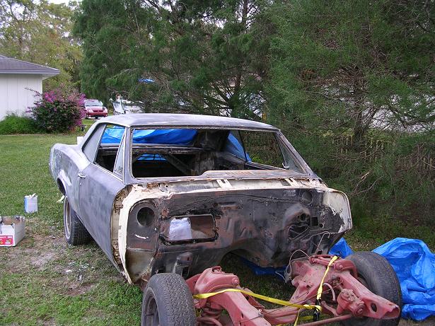

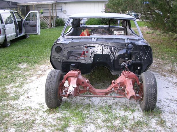

OK, time for an update. After much sweat I finally got a coat of primer on the outside of the new body. I learned a lot from the experience of stripping a car down to metal. After awhile I got a system down. It took 3 passes with stripper to get the paint off. Onr the first the top layer came off, the second took off the second coat, and the third took off the primer and left the original coating (not quite paint but not bare metal either). I found out that a razor blade scraper works best and you can get it really clean without too much pressure (i didn't want to warp anything). The biggest lesson I learned is to spend the $1500 - $2000 and let them dunk it (grin). I used the sandblaster on the firewall and it worked great but if i never have to pick sand out of my ears again I will be happy (got in them even under the hood).
I took the trunk lid, inner front fender wells, fenders, hood, hood hinges, and a few misc parts to a stripper I found somewhat close by (1 1/2 hour drive). They dunk them and they are suposed to come back rust free. I got the metal parts (rear panel, both lower rear qtrs, front floor pans, rear under back seat floor pans and inner driver side wheel well) and start welding class this Wed evening. I probably will not weld the outside parts but I think the inside stuff that will be under carpet or heavy paint are fair game. I made arrangements to have a fellow do the body work and paint that is a retired body and paint guy that does restorations and has some beautiful show cars. He has a paint booth and two shops on his property and I saw some of his work. He is GOOD. Don't know what it will cost yet but I'm not there yet either.
Ok enough jabber, time for pics.

  #98
Old 03-07-2005, 10:14 PM
Old-Goat's Avatar
Old-Goat Old-Goat is offline
Location: Lutz, Florida
Posts: 347
more pics

  #99
Old 03-07-2005, 10:18 PM
Old-Goat's Avatar
Posts: 347
the white stuff is not snow. I'm in FL it's sand (actually what didn't wind up in my hair or ears). The grey is ppg DP50lf the black is DP90lf.

Old 03-08-2005, 07:02 PM
karl emerick karl emerick is offline
Location: new baltimore,mi
Posts: 425
gene,
glad you're not suffering from 'inertia'. your project is going quite well. unlike so many others that just sit. and sit.....
and you're learning important lessons. like what you can do and what it's best to pay others to do to keep the ball rolling. those small green pieces of paper are invaluable at times for specialty work.
btw- anything you have dip-stripped.... make sure you really soak it down inside and out with a good primer/sealer and then paint it. the stripper leaves nothing but bare metal and you're ahead of the game if you saturate hidden areas and let it DRIP ON THE GROUND before removing the excess.
