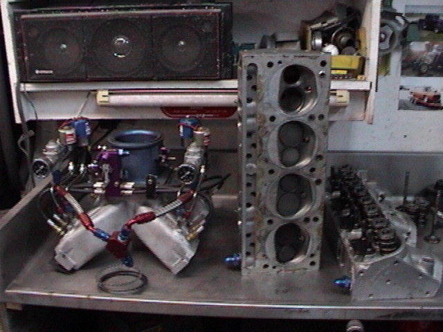

Slowbird, an E-head would not even start to compare to the Tiger Head. All of the money in the world would not make an E-head have the ability to keep up with this head in full race form. And E-head is tapped out at 370 cfm if you can even squeeze that out of it.
The unspoken thing about this test is the heat transfer of water to cool the head, worked. The exhaust temps we even and we had no detonation in the cylinders. The as cast head will live up to the promise of good power with out you spending an arm and a leg to have someone port this head. We put this port work in the head as cast.
We twisted a Eagle Crank on this test in 21 pulls. How that for power?
Here is a look at the intake ports as cast.

It is hard to tell by the picture but to me the ports don't look wide enough to require a 0.250" off set rocker arm.
Also been told they are only about 310 cc runner volume !
Interesting to compare, I have a set of 72cc Edelbrock castings that have the ports raised to match a tall 2.320" SCE gasket (a Felpro 1233 is about 2.200" tall) and using a 0.170" off set rocker they have been widened only enough to completely remove the pushrod bulge... they are not "wide port" heads by any means and the intake runner volume 234 cc's.
Also they have also been opened up to accomodate 2.150" intake valves.

I went back and read the HPP article about the prototype head and it stated the ports were 1.300 wide x 2.600 tall.
Again, hard to tell by the photo.
