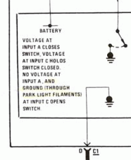

When I first cooked up this mod I experienced the same problem.
The picture below (clip from the TA wiring diagram) carries important information.
The input to turn the lights on and off needs to provide voltage for ON and ground for OFF. Simply floating or disconnecting the input will not close the doors.
Bob, That's a huge piece of information!!! That's got to be the problem, glad I posted my question here. Hope it helps someone else too in the future. Thanks, Dave
