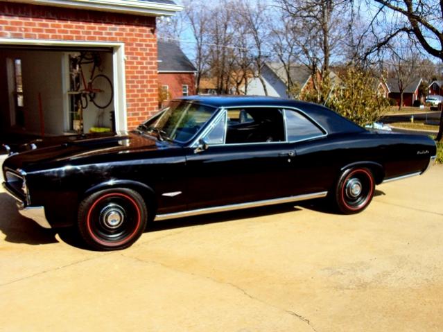

Default 66 GTO w/ Poverty Caps
15x7 GM steel wheels with BFG from Diamond Back 235/60/15 all around, hotchkis springs

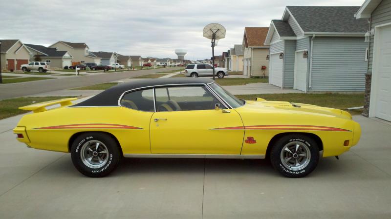

Default 69 Judge
Wheels and tires
Centerline Lazer II polished 17 x 8 fronts w/ 4” backspacing
Centerline Lazer II polished 17 x 10 rears w/ 5” backspacing
Goodyear Eagle F1 tires, 245-45-17 and 285-40-17
Picture with tire under rear of car is a BFGoodrich radial T/A is a 295-50-15, but shows what a 285 would look like.

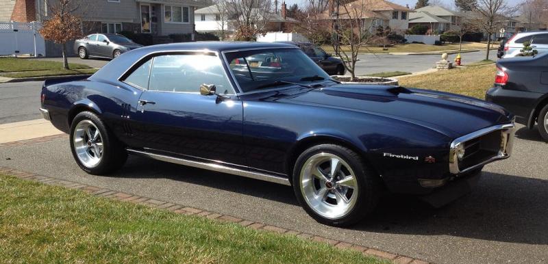

Front: 235/45/R17 Nitto 555 on a 9" wide/5" backspace Year One Rally 2 (will switch to 8" wide when they come in)
Rear: 255/45/R17 Nitto 555 on a 9" wide/5" backspace Year One Rally 2

Man that early bird looks good! Are those the polished wheels or is the center light silver? Can you get those in 15's 9" wide?
