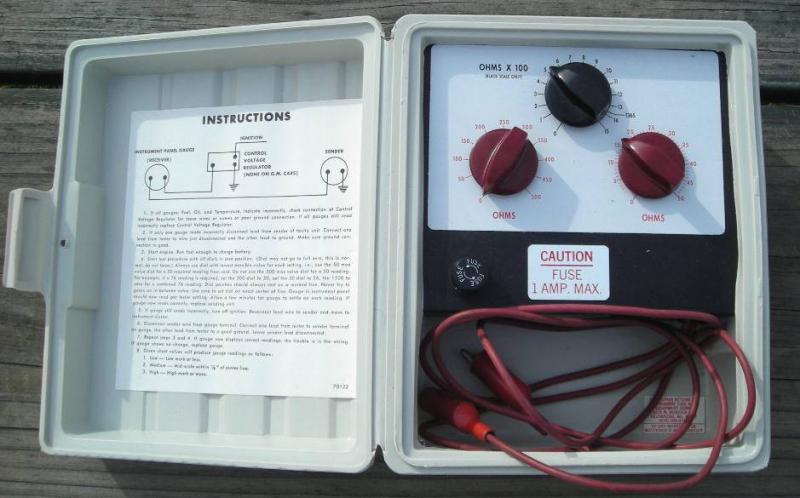

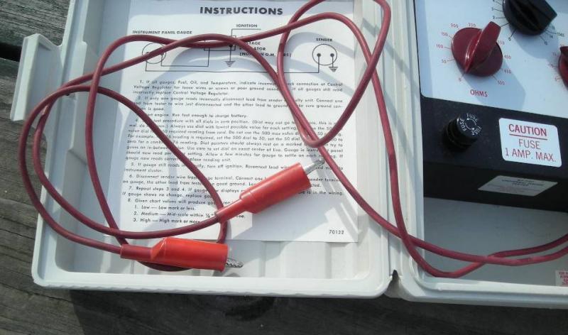

Default Older Kent Moore Fuel Gauge Tester
This is a very handy tester to have in cases like this. They show up from time to time on ebay.
Name:	Kent Moore Gauge Tester_Instructions.jpg
ID:	357783   Click image for larger version
Name:	Kent-Moore Gauge Tester_White Box_C.jpg
ID:	357784   Click image for larger version

Old 03-23-2014, 01:30 PM
Yeah, that would be ideal for simulating the sending unit resistance.. I used to have a couple of those that we called 'decade boxes' for testing different circuit designs, etc.. Just a bunch of individually selectable resistors. I'm assuming that's the same thing?
