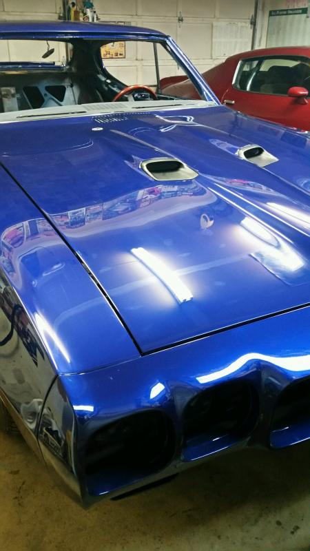

So go up this morning to pick the car up, it's ready to come home for me to get started on trim out and assembly.
Once I have that done I will take it back, have th stripes installed, and any blemishes repaired.
Here's a shot the one body guy just shot me, and it's waiting to go onto the rollback.
I'll get some more shots once I get it home....

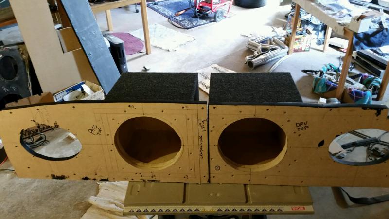

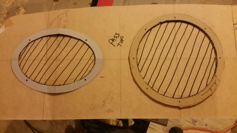

Sorry for slow posting, though I have been knocking some stuff out. With the heat index in the 105-115 range, it's tough to be motivated into going out in the garage.
Some have probably seen my rear deck and how I originally mounted a air of 6x9s and a pair of 10" subs. I did that in like the mid-90s, and always wanted to clean it up some, and build boxes for the subs, and not run them free-air. So I did...
Here's a shot of the original deck, was 1" solid pine, splitting from moisture, heat, and age.
Then some shots of me mocking, measuring, and creating the new rear deck. I used the original pieces and made some cardboard cutouts, held it up to the deck, and made it a little cleaner.
You can see I created 2 centerlines, one from front to rear, and one from side to side of the car. I then measured, and spaced where the speakers would go, and used the supplied templates with the speakers to make the holes.
I created 2 separate sides, for two reasons, one, the rear deck in my car isn't completely flat, had a slight arch to it, and to take some of that out, I even beat the forward portion down a bit. Second reason is that with the sub boxes, as one piece, it would be big, and difficult to manage/install.
So the spec for the subs is .65, I used .67 cubic feet (internal), since that's just the way it worked out. I had to use the area I had to work with, but feel it's close enough. Built the box, cut the deck, and glued/screwed the box to the bottom of the deck. (all 3/4" MDF). Then covered it with sub box carpet. I have some PV stack corner protectors that I will put on the bottom corners so they don't get beat up in the trunk.
On the bottom of the deck, I sprayed it with bed liner, so in case someone DOES stick their' head up there and look, it won't be raw MDF, and not look too bad. The bed liner should help keep the MDF from absorbing moisture too. It looks good, has a slight texture, is dry to the touch, and has a matt finish.
Once in the car, I will cover the top and down the back seat area with Dynamat, and then the deck insert will go over top, will look great.

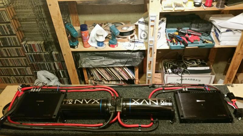

Also prepped and applied the Dynamat to the trunk floor. I removed the jack bracket, and the hold down loop, to make the floor a little more flat. I had POR-15'd the trunk floor when I first got the car, in the early 90s, and it is still perfect. I had coated it with splatter paint, grey & black, and any areas that were loose I hit lightly with a wire brush to remove, so the Dynamat would stick good. Once I get all the Dynamat done and the deck and amp board mounted, I will touch up the sides of the inside quarters and wheel houses with splatter, and top off with clear engine paint for durability.
Working on the amp board now, will mount the amps, a pair of 1 farad caps, a inertia cutoff switch for the fuel pump, and a fuse for the pump.
Included a shot of the inertia switch, application is a 2010 Ford Crown Vic, and is supplied with a convenient bracket. There's a couple different part numbers, but here's one from AutoZone:
http://www.autozone.com/fuel-deliver...?checkfit=true
Also got the pigtail, it's a Dorman part number 645-920. Found it online for $18 shipped.
Will have to see if the Crown Vic switch is too sensitive or not, if so, I will trade it out for a Mustang one or something.

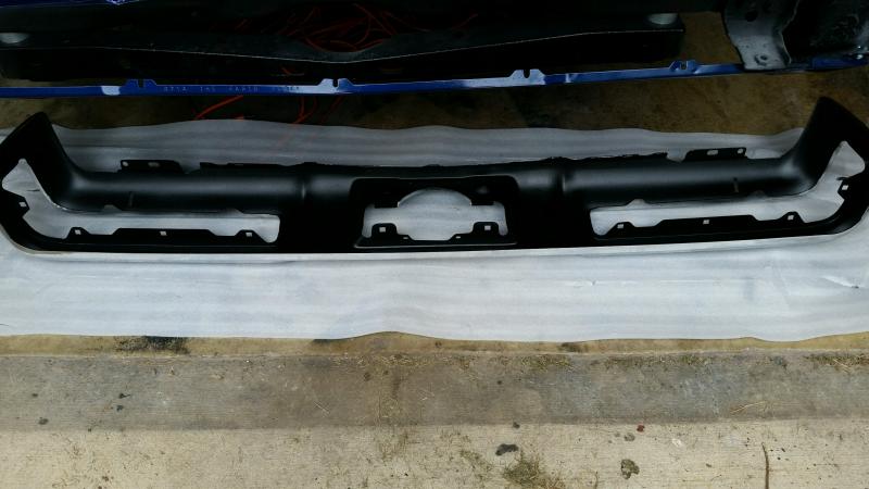

Also, prepped the bumper, cleaned it up, checked for any chips, flaking or lifting, and coated the inside with truck bed liner to help prevent future flaking.
@ time spent on above efforts = 14 hrs

So the inertia switch from the Crown Vic is a little too sensitive for my taste, think a big bump in the road would trigger it. I will have to order a Mustang one and see if that works or not.
I finished out the amp mounting board, and included the fuse and relay for the fuel pump. Once I find a suitable inertia switch, I will figure out where to mount and work it into the harness I made.
I'll get the amp board, rear deck with enclosures mounted this weekend and provide some pics. The pic of the amp board here is when it was almost done, and have to forgive the background mess!

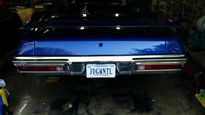

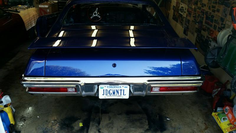

Got the bumper hung, did all the light housings, cleaned, sprayed reflective paint on them, mounted, and did the plate light and holder. One thing on the repop bumper is that the brackets, the area that the light housings bolt to, were off, the gaps were different from side to side, so have to wobb out the holes to even it out. Not a big deal, but worth mentioning.
@ time spent on above effort = 3 hrs

It's an Ames bumper. Which gaps do you mean? The ones I'm talking about are the gaps towards the center of the bumper between the tail light housings and the bumper itself. The driver side was off by about 1/4-1/3 inch, the gap was larger than the passenger side.
There's 3 bolts on each that hold the light housing on the bumper, and 2 alignment studs (plastic) on the housing. Those go into the brackets that bolt to the bumper, and those I had to enlarge to close the gap. It allowed me to move the housing towards the center of the car more.
As for the rest of the bumper, if I'm going to be picky, all along the very edge of the bumper, there are grind/file marks where it was cleaned up before it was chromed, and it's kind of rough. It could have easily been made smooth with just a little extra work. But I think even the factory ones looked that way.
As for shape, the contours, and overall shape of the bumper is good-very good, and the ends are formed as they should be. There were no twists in the one I have, and the ends are not too far in or out. They are even side to side.
If you look at the one shot of the bumper on the car, at the lenses, you can see there's still about a <1/4 inch gap difference. It's so close though you kind of have to stare at it, and only reason I notice is because I know what I'm looking at/for.
EDIT: Guess it would help if I added the pics! Thought I had done that!
