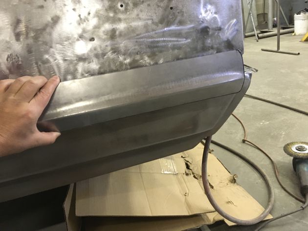

The roof is done to the point that it has less than about 1/16" variance in height which should allow the whole thing to be bodyworked without excessive amounts of filler. The roof seams and two areas where the patch panel joined the windshield channels have been leaded. And all the bare metal is in epoxy primer to protect it.
Also a little more work was done to the passenger quarter to get the quarter panel extension to fit way better than the factory fit. This involved making a small piece of the quarter and welding and planishing it in. This has been an area of these cars that I notice - to me the detail of the quarter extension fit is often the difference between a nice car and a really nice car.

Name:	Extension Patch 1.jpg
ID:	524329   Click image for larger version
Name:	Extension Patch 2.jpg

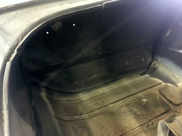

Hi Everyone,

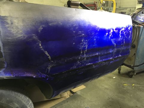

A little update in case anyone is following along with this resto...We are under the knife (well cut-off wheel) again. This time a previous repair to the driver's quarter is being addressed. I had considered leaving it more-or-less as is, but everything else was coming out so nice.
The driver's quarter had a patch in the lower quarter which was installed with a flanged and partially welded seam. This quarter also has some collision damage which was poorly repaired.
Here is a photo of the damaged area after long boarding the layout blue showing the "bag-of-walnuts" look of the panel.
The repair consists of making a new patch panel to eliminate the previously welded seam. This patch will be gas-welded in place and planished smooth make the repair essentially invisible. Some hammer-and-dolly work will improve the damaged area of the quarter. I will post some more photos of the work after it is completed.
Thanks for following along. I hope everyone enjoys watching the progress.

Hi Everyone...
Here is a look at the work as it is progressing on the driver side quarter panel. Work with a slapper and dolly straightened the collusion damage, and the new patch is welded in.
The area still needs finishing to address the welded area and the distortion from the heat. But all-in-all it seems to be shaping up well so far.

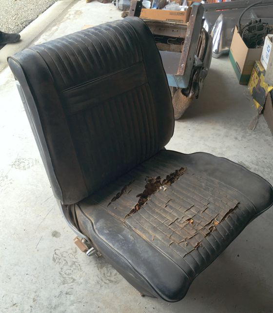

Today - I checked out and purchased some seats that had been listed on Craigslist locally. Thanks to the PY Forums (and Chief in particular), the seats were ID'd as '64 Olds A-body. So now I have a correct set of seat frames and sliders to replace my later-model seats that came with my car.
ID:	534072   Click image for larger version

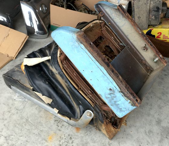

What’s the story with that metal box on the bottom of the seats?
1965 Pontiac LeMans. M21, 3.73 in a 12 bolt, Kauffman 461.
  #99
Old 03-08-2020, 12:39 PM
1_Wild_Cat's Avatar
1_Wild_Cat 1_Wild_Cat is offline
Join Date: May 2012
Location: Idaho
Posts: 561
Hi Chris,
It is a seat riser from the last vehicle these seats were in. I thought he said an old Chevy (K5 maybe). The feet of the sliders are tacked to riser - so it will take a little careful work with a cut-off wheel to free them. Here is a different view...
