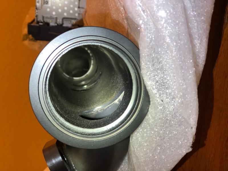

Can we get a photo of inside the port area? Thanks
  #87
Old 11-30-2019, 08:34 PM
GOAT8U2's Avatar
GOAT8U2 GOAT8U2 is offline
Location: Prospect Hts, IL
Posts: 896
Looks great, awesome to see a bolt on, affordable V band for the Pontiacs. Would like to see any future GTO cross over for a single turbo and down pipe and the twin turbo down pipes.
69 GTO Convertible, 4000lbs
462ci, 606tq/569hp - 93 oct @ 34 deg (207psi)
11.7:1, KRE H Ports, Lunati HR 282/290 w Johnson Lifters & 1.65 Scorp, E30, EFI, Holley HP + Dual Sync, 12-1 Crank Trig, 120lb Inj & 1000cfm TB, Torker II EFI Int & Rails, PTC 10", Rock Valley SS Tank, Dual 450s, Aerom EFI Reg, Aero Front & Wilwood Rear Disc Brakes, Dougs 1 7/8" & Borla Pro XS 3", Alum Rad & Dual Fans, 12:1 Box, UMI Arms & Viking Berz Fr + Rear CO Shocks, Hella UP5.0 Vac Pump, 12 Bolt, 3.73, 33 Spline
  #88
Old 11-30-2019, 08:37 PM
AIR RAM AIR RAM is offline
Location: Homestead FL
Posts: 412
Sure,
These are the best I could get with the poor lighting I have around my home... I can take better pics tomorrow...
