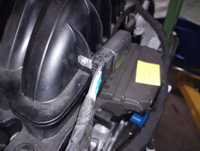

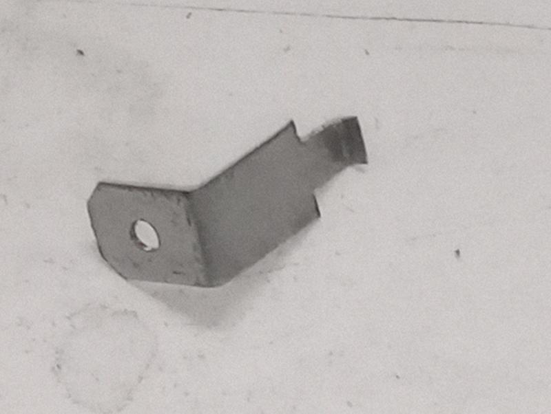

The engine harness has a plug that connects to a sub-harness which runs off under the dash mating with such things as the OBD II port and pedal rheostat assembly.
Needless to say we don't want such things just flopping about so this wee clip was fashioned. It slips in the plug and then screws into the intake assembly securing it Bristol fashion.
It is the details that take so damn long to do here.

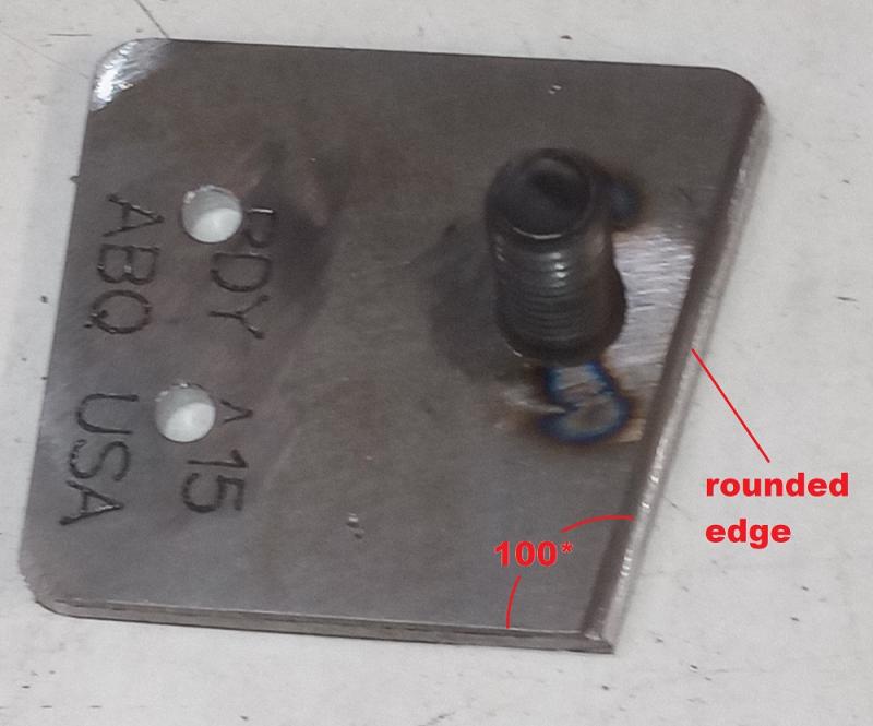

PS pump revisited. I spent a few hours and money designing a nice mount for the 1998-02 F body pump and now see this little bugger exists. Seems some of GM's 3/4 and 1 ton truck may still use hydraulic steering and require pumps.
Dammit, just $26 too. GM #12654286 mounted on unknown engine with same water pump.
My 2nd design lowered for better clearance of upper radiator hose:

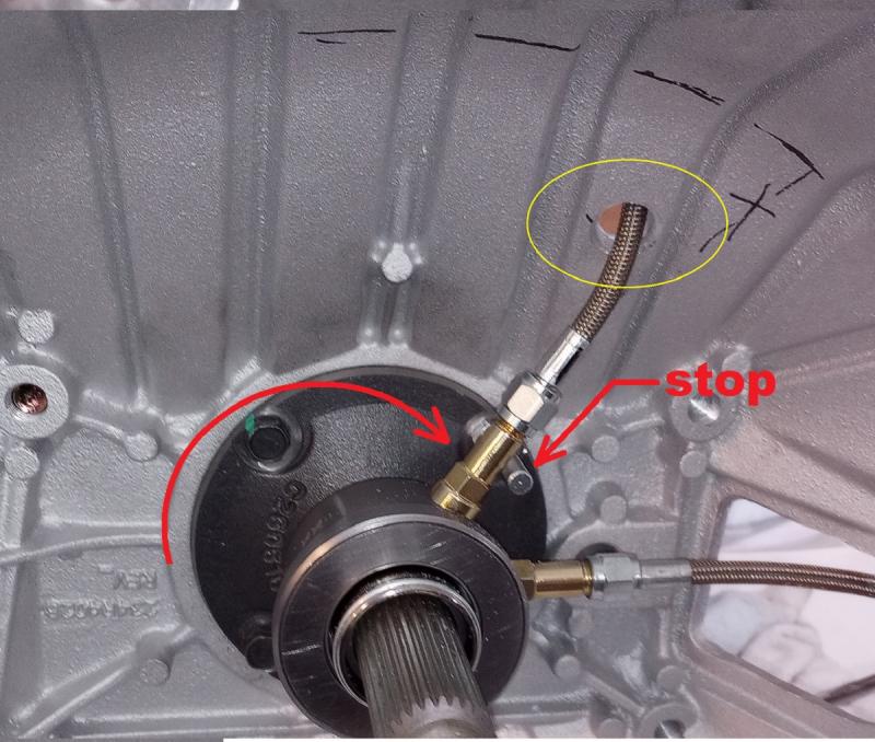

Dropped the engine in hopefully for the final time. Exhaust manifolds do not allow the use of mechanical linkage so hydraulic throwout it is.
Not really a difficult thing to do, just have to check a few measurements. First off is the clutch depth from the bellhousing face.
Secondly is the throw out bearing to the trans face. The different minus 0.060" is the amount of shims you will need for proper disengagement, in this case 0.500. The shims are usually provide by the supplier - in this case Howe Racing. They are affordable and quality units.
Hydraulic bearings have 2 fittings; one for pressure, the second to bleed the system.
As you see routing the bleed line thru the arm hole will create a huge bubble trap, not allowing proper bleeding. So a hole was drilled between the ribs of the bell housing for the hose to exit the bearing.
This will work except the 18" hose is too short for easy access (it barely peeks above the engine).
A 28" hose is on order.

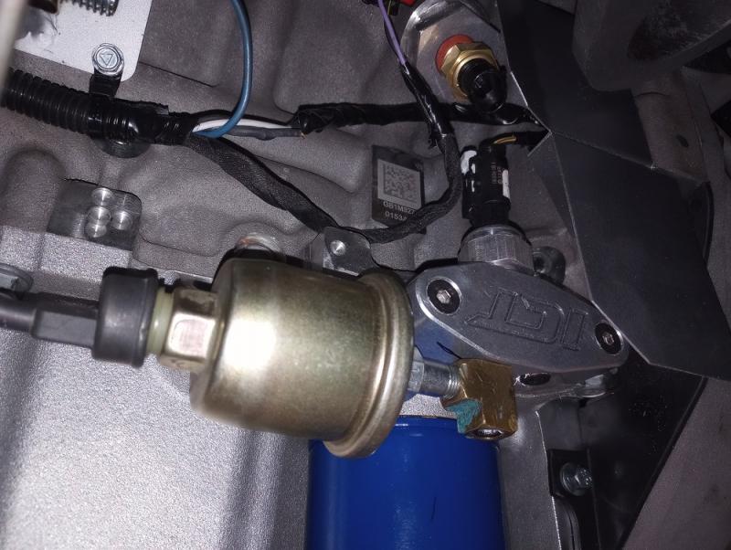

As noted before I am running the OEM steam gauges currently, so need to have senders. I used the block heater port for temp, and Swap Time sent a nice billet piece from ICT for the oil pressure. It has an O-ring instead of a gasket along with 3 ports and a pair of 1/8" pipe plugs.
I also fabbed a heat shield. My first car was a 69 Cutlass S, they were notorious hot starters due to solenoid heat soak so everything gets shielded here!

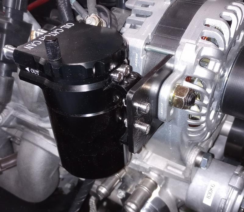

Old 11-04-2022, 11:55 PM
Posts: 5,386
I think that this can should work fine.
It is all billet aluminum with a bunch of fittings. It has a small chamber inside that looks like it should have some mesh or steel wool for the oil droplets to coagulate and drop to the bottom.
A simple bracket was fabbed up - mounts snugly against the alternator bracket as shown.

I must have missed it, but do LS engines have a separator for case venting? Or is there a problem with the OE setup?
That's a pretty sweet separator by the way. Who makes those?
  #100
Old 11-05-2022, 10:10 AM
Posts: 5,386
Thanks.
LS motors do not require them as they are port injected. LT motors are direct injection so have no fuel wash on the intake valves, supercharged motors have this issue worse and so have factory separators. The OEM units won't fit on the 5.3 due to the water pump design.
