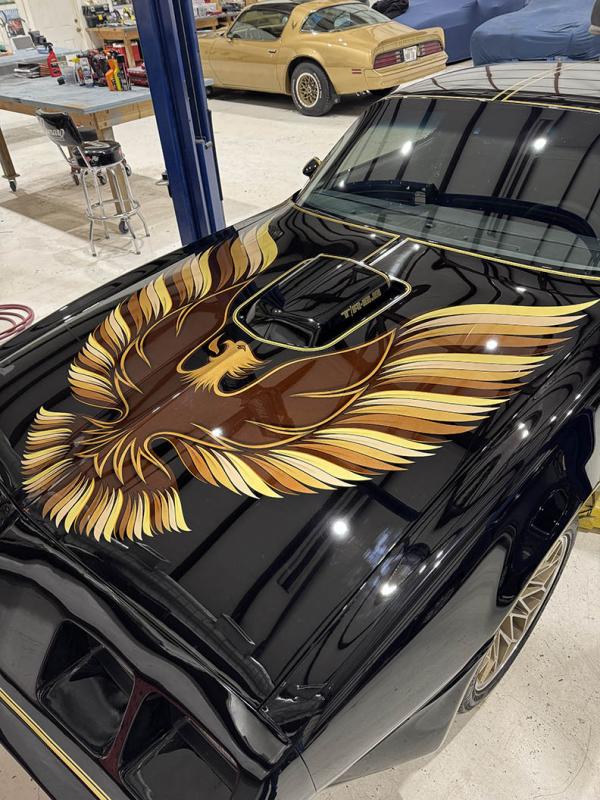

Gator, Fantastic build on this TA. Love the work and the parts choices. I just finished up a 79 for a client and used alot of the same. As for the graphics, you cant go wrong with the full special edition set. For my client, I spiced it up a bit and had Joe Martin of Martin Brothers Customs here in Tx custom paint the hood bird. He did a fabulous job on it. Here's a pic
Cheers,
Evan Q.

Nice paint job on the Bird!

Yeah, that bird does look great!
