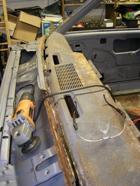

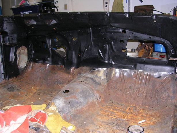

Well for some reason I haven't been able to get much done recently. I did get the other body down from its perch and got the good body in the garage. With welding class 2 nights a week, and teaching one night (thats 3 nights), and the rain weve had, I feel like I'm standing still. I've got all the pans in that I am going to replace (I think). I am going to replace all the floor pans and the trunk, the drivers rear wheel well, and the two lower qtrs. It sounds like a lot but is nothing compared to what I would have had to replace on the other body. I cut the dash out as it had some holes up close to the windshield and since I have a good dash and windshield channel from the chunk of car I bought for the first body. I am going to try to take the dash and channel out as one piece and weld them into this one.
I cleaned up underneath the dash and gave it a coat of Rust encapsulator. Now there realy was not a lot of rust but with all the nooks and cranneys (sp?)under there I didnt want to take the chance that rust would pop its ugly head.
I guess thats about all for now. I'll keep you posted.
the dash before

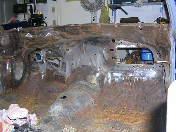

rust sealed

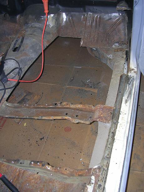

Well I started cutting floors and replacing pans. It's taken two pans to get used to this cheap welder and the pictures are EXTREMELY kind to my welds. I found the wire feed is inconstant and it was making me crazy but I think me and the welder are now on the same page. Four more pans inside to go, and then the trunk and wheel well.

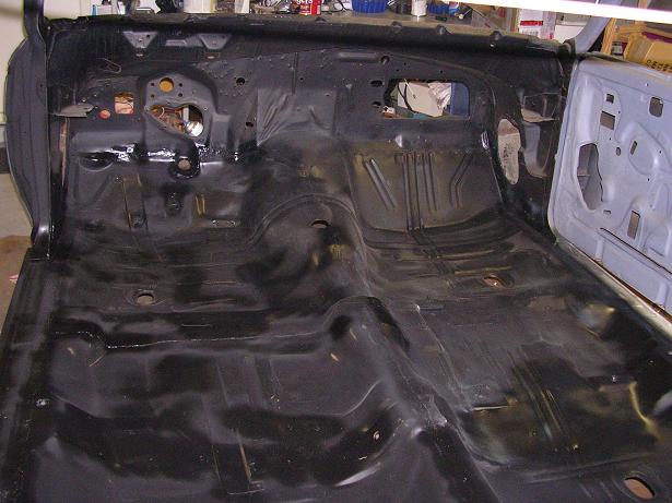

Well it's been awhile since I wrote an update. This thing called life keeps getting in the way of my progress. Well the business trips, the lingering cold, the neices graduation from college, and the son's wedding completely across the country, are over, and I've had a little time in the past 3 weeks to do some work.
I took the fenders to the guy who will be doing the outside body work and he took 4 fenders and a set of patch kits and made two beautiful fenders. He's got the hood(s) now.
I managed to get the driver side pans in and now the two under the rear seat pans are still to go inside the car. The trunk and fender well will follow. The welds are getting better as is the fit of the pans. I guess I'm learning something (maybe what i'm learning is to buy a car with NO rust).
Anyway, here are a few pictures of the pans (some of the primer is still wet so they look a little blotchy.) I'm thinking I'll use eastwoods underhood black to finish them off once I've caulked everything.

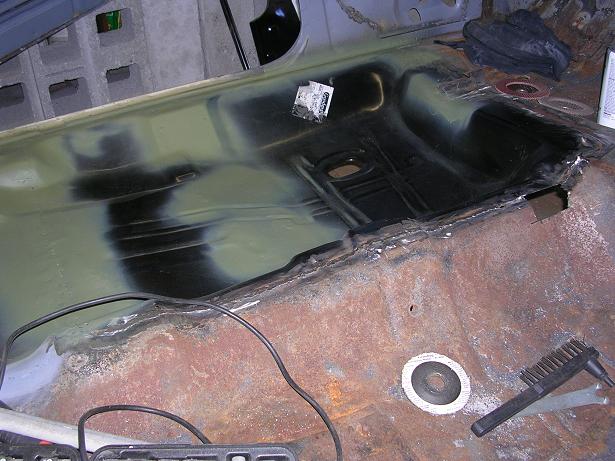

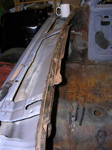

Well things are starting to get serious. I was installing the underseat pans when I discovered that I was not going to be able to just cut the sections out and replace small sections like I had first thought. There were some small rusted through areas all the way at the top of the pan. I took off the bracket that holds the package try braces and behind it was rusted through. I started looking around and figured that I wouldn't be able to replace this pan without first replacing the inner wheel well for that side, since I would have to try to get a tight fit between the pan and the well. Well there is part two of having to do more than I first thought. I thought just the rear section of wheel well would have to be replaced but when I looked real closely, the areas above the flat section between the rear seats and trunk pans had rusted through areas. (This seems to be the story of restoration, figure out what you need to do and then triple it. ) So I replaced my first wheel well (well half of one anyway). There is a lot of stuff attached to the inner wheel well so I didn't want to get into all that with my limited experience so I replaced the bottom half of the well. To make a longer story short, i'm pleased with the way it turned out. The fit between tot old and new is tight enough that I don't think anyone will notice it one I have everything cleaned up, cauked and painted, and the fit between the underseat pan and the well is pretty good. Se pics

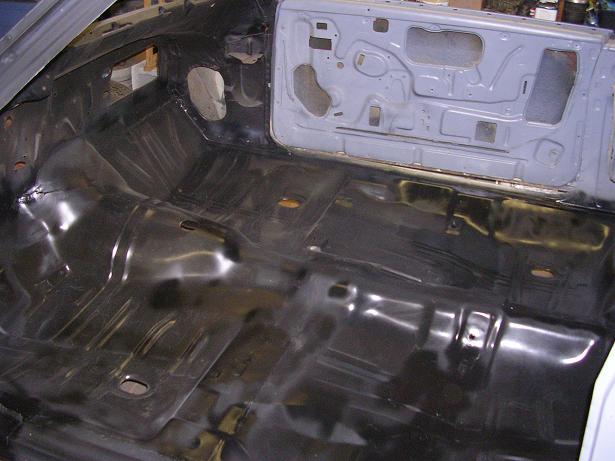

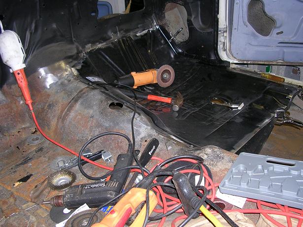

OK, I'm almost ready to yell UNCLE. I never realized just how much work (and tedious work at that) there is in doing body work on a project car. Seems everywhere I turn I find a little rust spot here, and a little one there, that needs to be taken care of. I finally finished the under seat pans. What a royal pain they are, with the seat belt anchors and the bracing for the package tray ( which I pulled from the other body since they were in better condition).
OK I've vented. What this means, is now all I have to do is the trunk pans and the car will be ready to have the underside cleaned and painted, and then put on the good frame and drivetrain. The body guy finished the hood (he is truly a magician) and it looks great. I need to clean up the doors and will take them to him next weekend. It's really getting much closer now and it's exciting to start to think about things like chrome shops, and upolstry etc, since those are the things i will be working on while he has the car for the outside body work and paint.
Some pictures of the completed under rear seat pans
