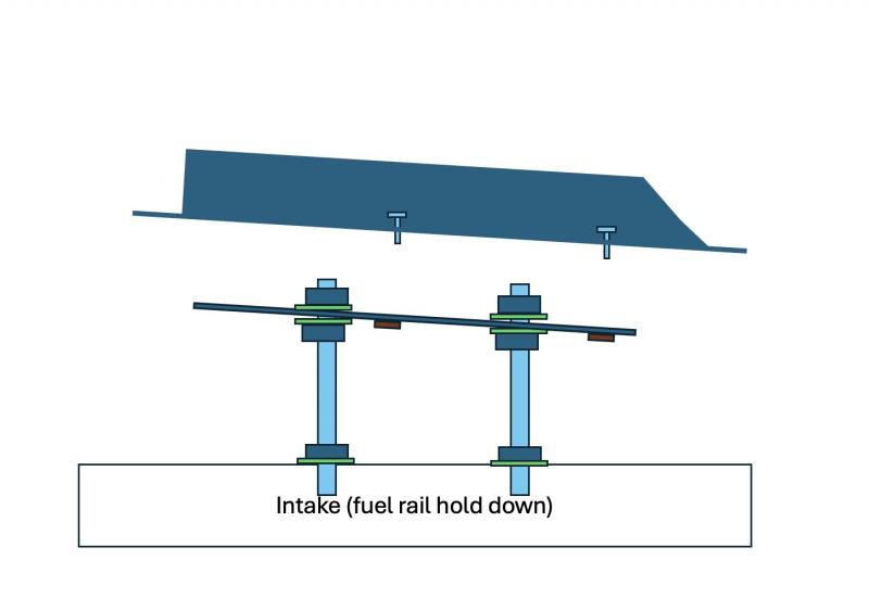

Originally Posted by JUDGE3 View Post
Shaker is done (except for the drain hose).The stanchions we built are adjustable so can easily tweak the height of the shaker.
can you post a picture of the adjustable stanchions you built? I am anticipating the need on my upcoming engine swap in my 79. would really appreciate it.
We tried a couple different designs, and this one turned out the best. Essentially, I screwed threaded rod (M6) into the holes used to secure the fuel rail brackets onto the intake (this is a good location because the stanchions are inboard and not very visible). Secured those in place with nuts. We covered the threaded rod with some black hose so it blends in. We then made a shaker base from some sheet aluminum, which sits on washers and nuts (hence the adjustability). Installed nutserts under the shaker base. Shaker is held down with some really flat button head screws.

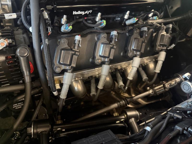

Posts: 1,866
We received the new stainless long tube headers from Ultimate Headers and installed them today. Pleasantly surprised we didn't need to remove the steering shaft and we were able to remove & install the AC Delco starter (and heat shield) with headers in place. Existing spark plug wires and dipstick worked fine. The new headers are 1 7/8" but definitely more compact than the 1 3/4" Hookers that we replaced. Most important, it looks like we'll gain about an inch of ground clearance...LH and RH sides about the same height...about even with the frame rails. We'll reinstall the rest of the exhaust system over the weekend. Would definitely recommend these for a LS swapped pro-touring style second gen bird.
