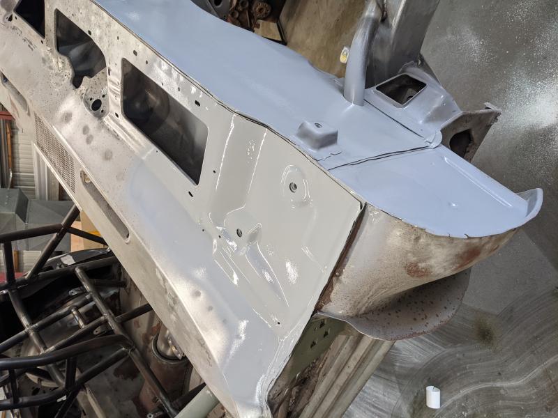

Default Primer party
So after quarter panel replacement, cowl repair, firewall smoothing, roll cage and chassis mods it was time to get this thing in epoxy primer. I know it should have been done right after media blasting so don't shoot me. Gathered up family and friends and armed everyone with sand paper, scotch brite and wire wheels and about 5 hours later it was back to surface rust free bare metal. Shot everything with black epoxy. Then with my favorite undercar paint, Rustoleum semi-gloss black thinned 4:1 with acetone.

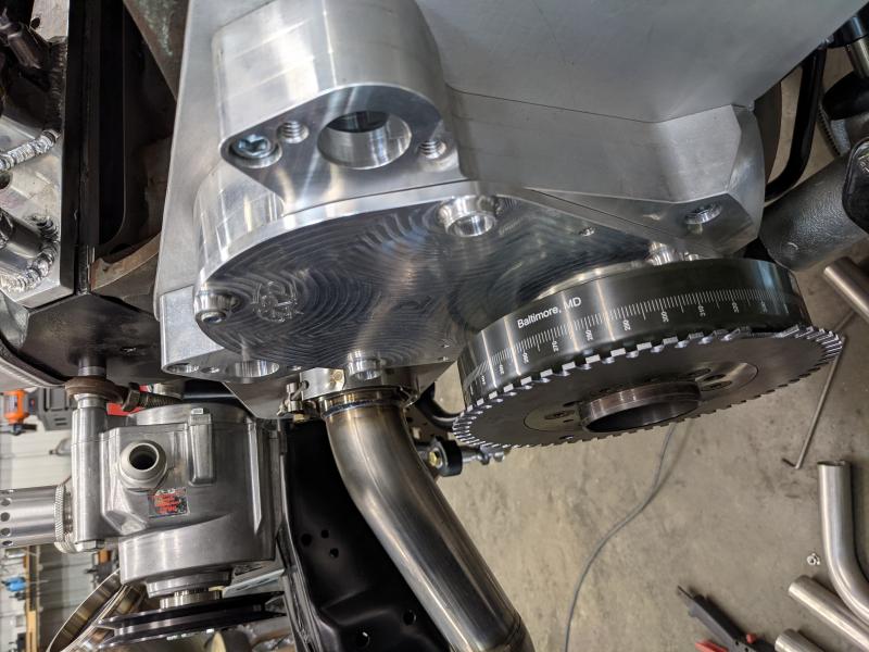

ErikW's Avatar
ErikW ErikW is offline
Posts: 1,393
Default More Progress
Some final assembly and more mock up pics. Nick carved up some drive pulleys for the alternator and vacuum pump out of a 6" billet of aluminum on the lathe. Then fabbed brackets for them. I got the brakes plumbed and bled. Got to have wipers for drag week so we got a lightweight Newport Engineering wiper motor and installed that. I got Nick a Kirkey containment seat instead of the regular drag seat so he had to do a little tweaking of his original mounts for that but I'll feel better knowing he's safer. Started some final assembly of suspension components. More to come.

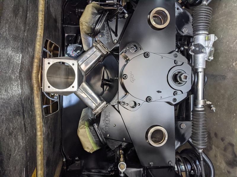

Default Intake
Nick machined a mounting flange to build to then set to work.

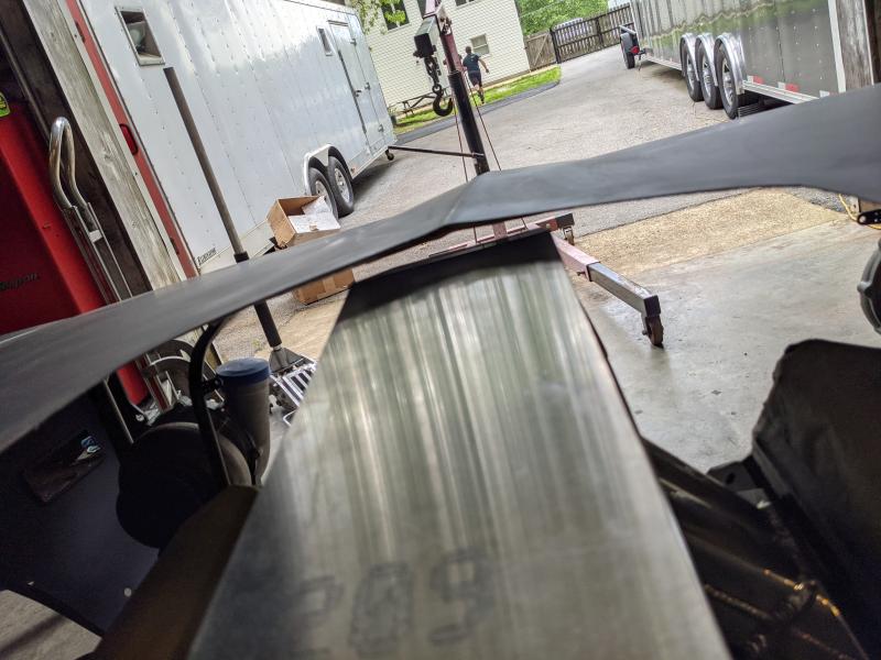

Default Intake
More building then a test fit to make sure she'll clear the hood.

Old 05-15-2021, 07:29 AM
Posts: 22,514
Nice work!
This sideways pic upload is really getting annoying! Don't know what's up with that.
How did you hold the camera with the last pic, looking through the hood?
Use that orientation?
(looks like hold camera 90º rotated to the right from normal way)
