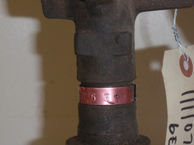

Hello gentlemen, I believe this to be the original distributor. It was in the trunk parts bin… the original owner did mention that when he added the hood tack, the distributor had to be changed. Not sure if this is correct or not but can someone please confirm this is the original distributor thank you as always.

Looks to be a correct number according to the Wallace site. 66 Experts will know more for your motor / trans combo.

Chart says its the right application.
Date code is good. March 14 1966
He might have went to a 1967 aluminum distributor with the 67 hood tach.
Or he might have gotten an aftermarket dual point distributor.
Shouldn't have needed it though - tach gets signal from the coil.
At least the correct one is in possession .
Not sure where I got stuck on 1111054 being TriPower distributor.
That might have been one of the flubs from the 1980's GTO Restoration Guide book.
Something somewhere made it stick in my mind ... idunno
