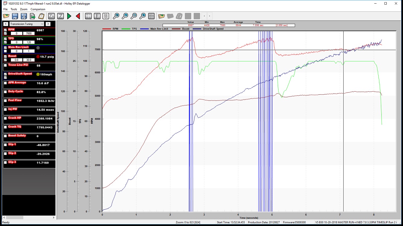

Partial datalog from an 8.05ET 177MPH pass

injectors were 160s fuel pressure was higher to help compensate for addition fuel needed as boost increased.

looking at your graph you are lifting foot off of accelerator a number of times and the convertor may be tight for the boost your running. jmo.

X2 on convertor. Do you plan on running higher boost?
On the lifting. Did it spin the tires on the 1 - 2 shift?

Yeah, it spun on the 1-2 shift. I do plan on running more boost.
