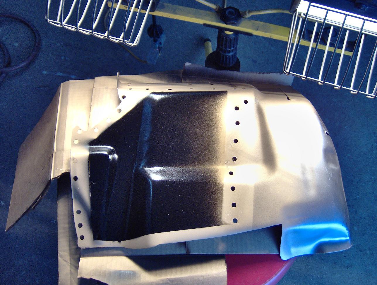

These pictures show the cleaned and painted area which the Toe board covers. I wire wheeled and sanded the area quickly as there was no rust, finally. I then wiped with picklex then sprayed with rust encapsulator with Chassis black over it. The other areas got sprayed with weld through primer, I guess this car won't rust from the inside out.
I also sprayed the back side of the toe board with the same weld through primer first, then taped off where no welding would be and used the same painting process as listed earlier. The only hard part was lying uncomfortably on the frame performing the welding. I did find a company online wich I thought had good pricing on the twist lock sanding discs, so more of the welds will be cleaned once they arrive.
