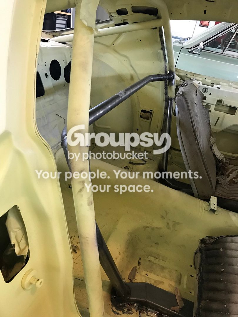

Forgot to mention, we decided against any sort of door bar. The chassis guy thought the benefits of the design we had in mind (angled down from the main hoop with a sharp bend so the bar would be lower than the entire seat bolster) wouldn't be worth it. I was actually relieved. Now I won't have to worry about those bars being in the way and the interior will look a lot cleaner.

The car is back home. Just waiting for my spot to open up at Randy's. Not sure what I could be doing now to move the project forward. Won't assemble the engine until the car is painted. I guess I can plan out the wiring and interior, maybe the Vintage Air stuff... Anyways, here's what happened this last week...
Triangulating pieces and seat belt bar welded in.
