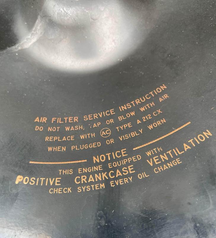

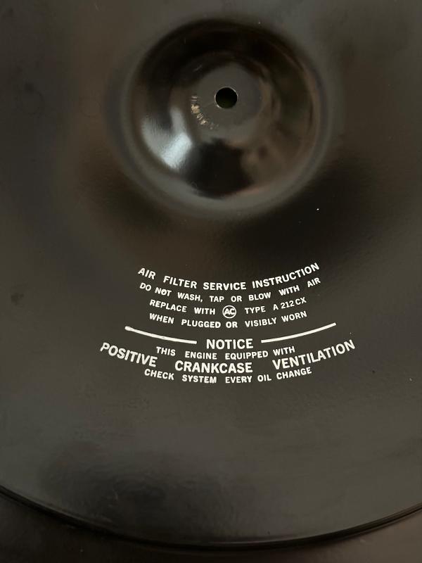

I paused on the '70 labels and picked back up on the '67 HO and '68 Ram Air air cleaner screens since I had a few requests for them. These were tricky to get the size and the text right! First pass came out pretty decent.

Wow, very nice.

Wow, that looks great! Your screen printing quality is impressive! You seem to have this down and I expect are building a following!
