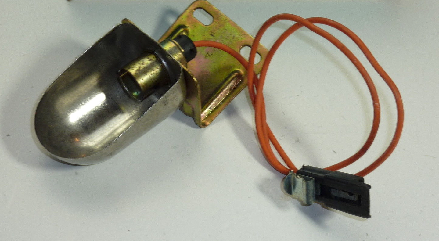

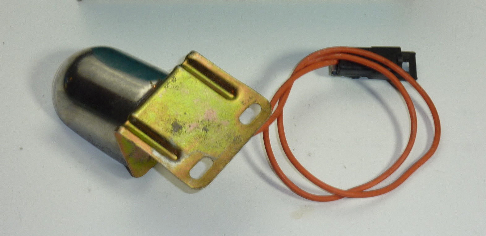

I'm looking for a correct 1971 Underhood light for a Trans Am.
Does anyone know if this is the correct part?

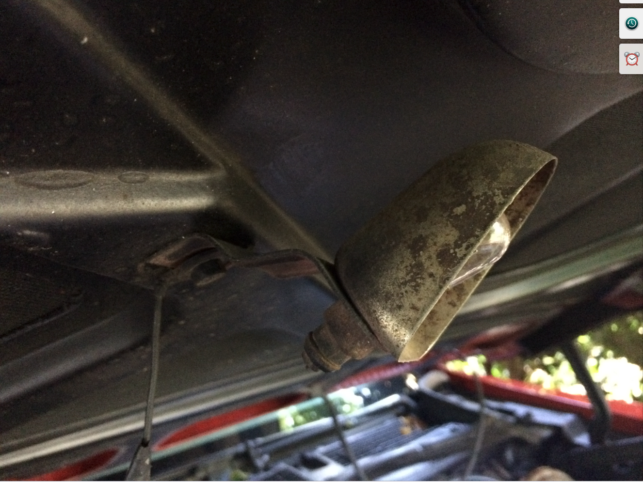

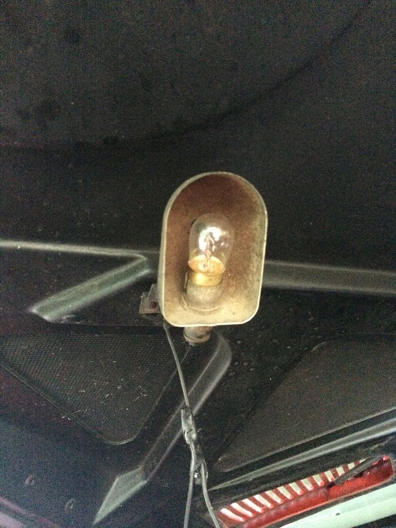

My build sheet says otherwise as it has the "conven lamps" (661) package and then individually lists an underhood lamp.....I also have a single mounting hole underhood in the spot as shown on the assembly manual. BTW, as far as I can tell the "correct" underhood light fixture only has one screw mounting hole which would jibe with the assembly manual as well as the attached pics from a '71 formula with the "conven lamps" (661) package.

IMHO,...your pictured lamp assembly is an incorrect reproduction part that some venders offer as "original". The only original Firebird underhood lamps I have ever had were on '71-72 Esprits, & they had a single screw mounting somewhat similar to what HiyabradHO shows.
