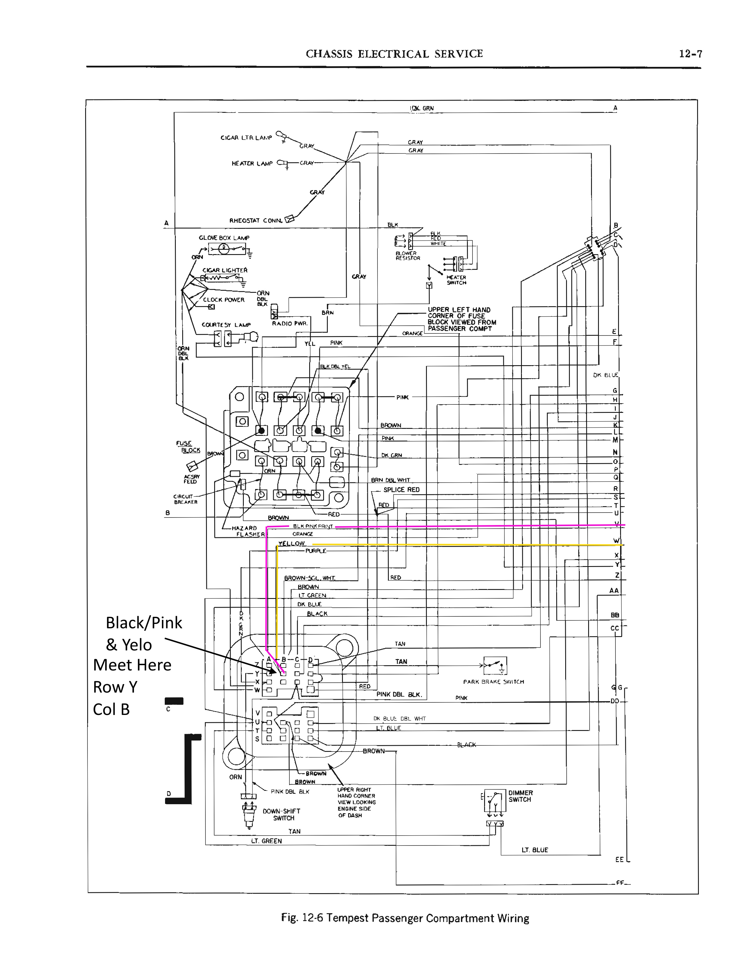

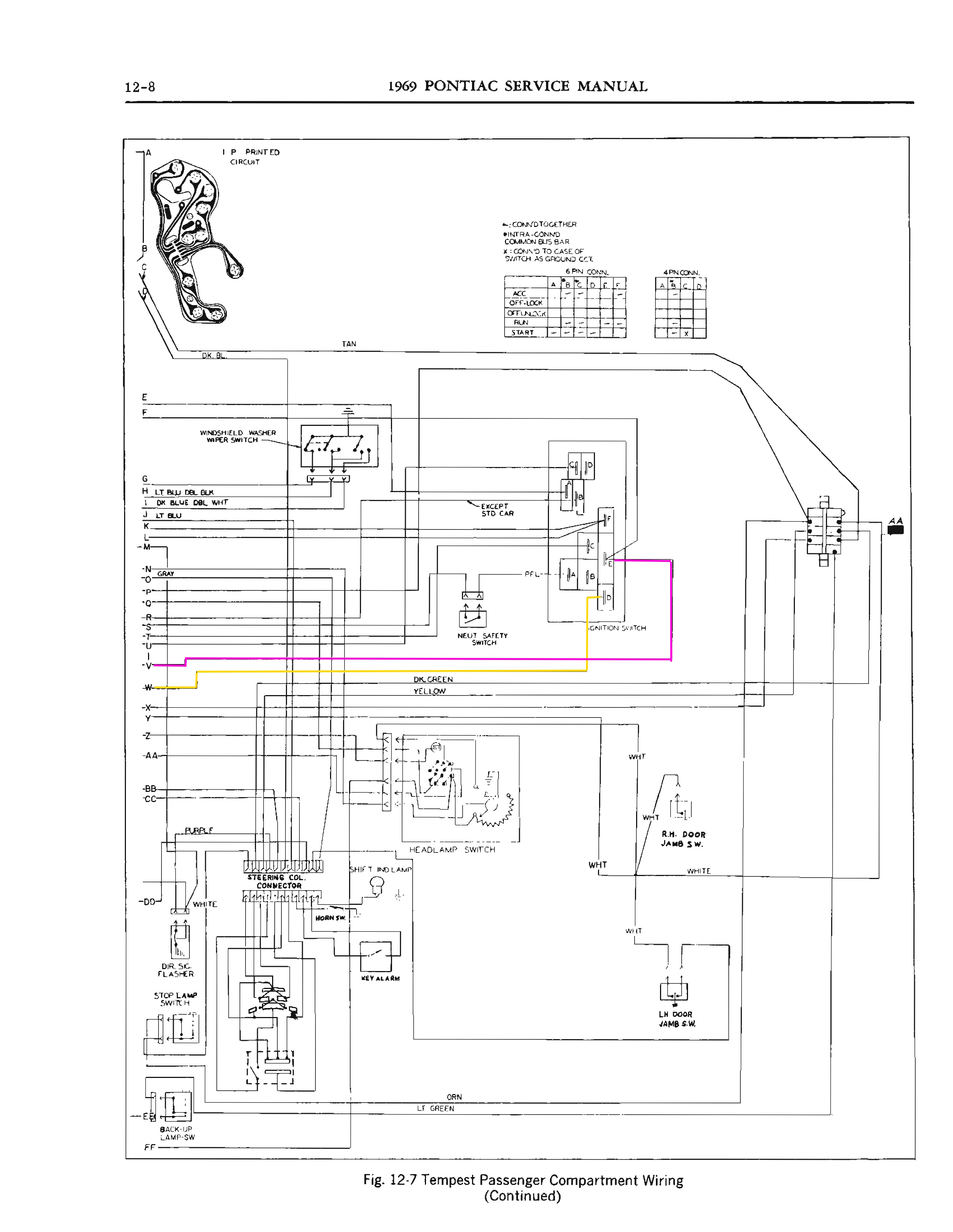

Here are pics of schematics:
The only place they 'meet' is at the firewall connector. Should be NO 12 volts at Yellow except in Start position.
