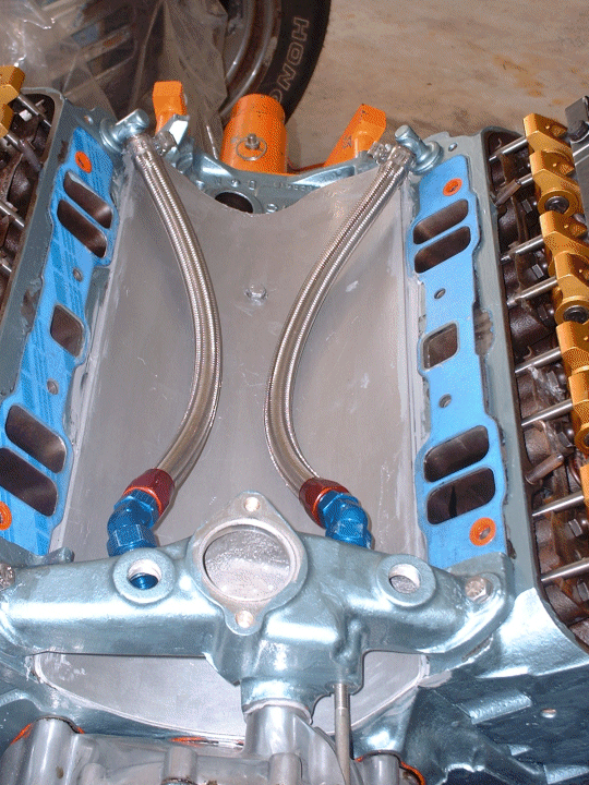

Depending on how much work you want to do here is what I did. I removed the heater core, plugged the outlet on the timing cover fo the heater hose, and routed the water from the back of BOTH heads using the 301 nipples mack to the water crossover. Many have done this with excellent cooling results. Below is a pic of my setup before I put my intake on.
Honest dad, that 455 on the side of the block is a serial number

67 that's a common mod for circle track cars and is good for some temp reduction on the street also.

67 455 Bird nice mod for cooling. However, I have an old motor with an aftermarket intake and really don't know how or attempt and potentially costly modification to the old girl. How can I avoid or know if there is an air pocket in the head as you guys have mentioned since I certianly don't want to find out the hard way and have it overheat. I'm currently replacing the fan clutch. The only thing about the one I bought that I don't like is that the mounting flange has four open "U" shape cut outs in place of thru holes for the mounting bolts to attach the clutch to the water pump. It came with new bolts and split washers. What is the purpose or advantage to using the split washer over a solid washer?

If you look at the picture again and then think about where the Water pump actually pulls water from, then you will see that he is feeding cooler water to both the front and the back of the heads at the same time. The water pump pulls from the block and with the cooler water going to the front and the back of the head I would think that all four corners of the block would run cooler then the center ie., 4,6,3,5. but I'm sure only slightly. I was going to do something like this on mine but I was going to feed both heads back to the water pump heater connection. remember that the water pump pushes water to the bottom of the radiator and then returns thru the upper hose back to the engine. I would be interested in tempetures taken at various points on the block to see whether there were (hot Spot's) in the block. Nice job though!!
