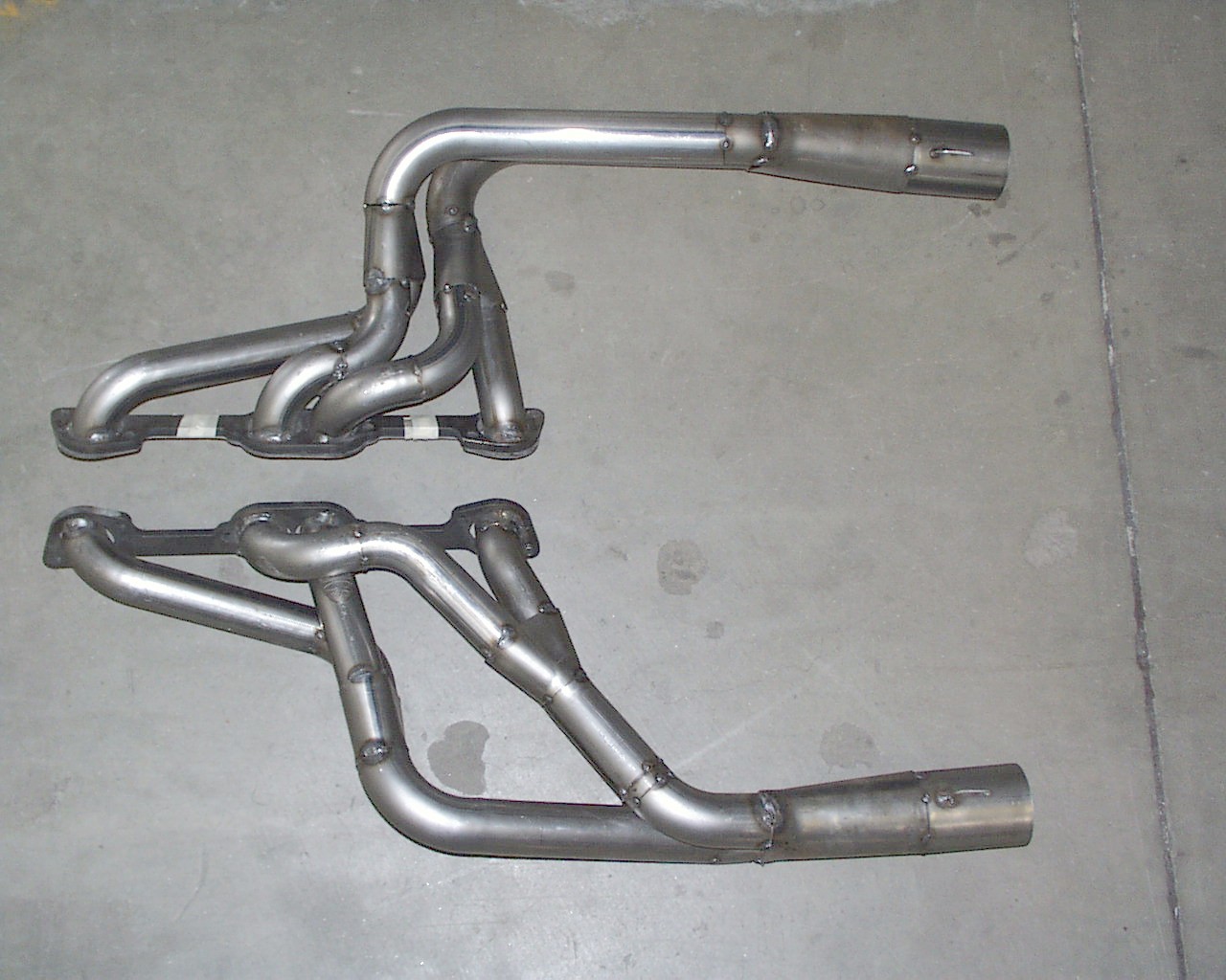

Okay those who have patiently waited......the latest pre-production pictures of the soon to be released Tri-Y headers for 2nd generation firebirds.
These headers have been painstakenly formed to gain unobstructed access to the engine starter and oil filter. They also provide excellent ground clearance over anything short of an exhaust manifold. Those of you who own a firebird with lowered suspension will appreciate that!
These will be available in D-port and O-port configurations with primary tube size of 1.75" with 2.5" dia. and 3" dia. collectors! Also, features a 3/8" thick mounting flange which virtually eliminates any warpage.
Thanks to "TUNNELPORT" Ron for his time, hard work and persiverance to see this product through.

VERY nice, Larry!
Looks interesting enough that even I might try a set on my Formula.
As far as bolt access, from this one view it appears that the only PITA bolt will be the fourth one back on the passenger side.

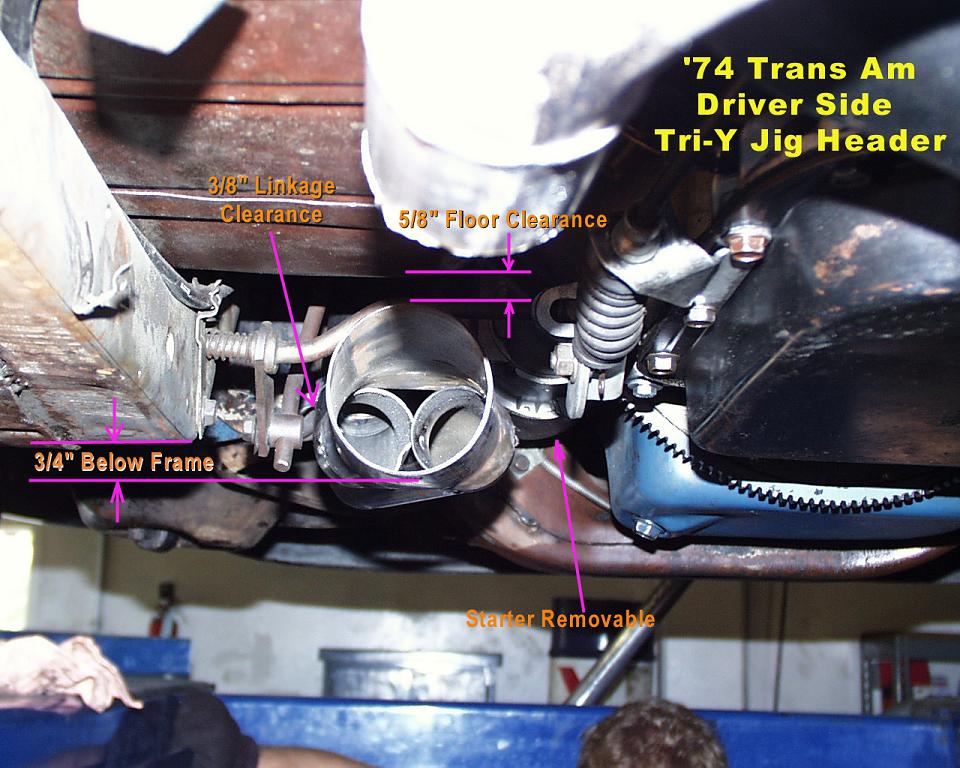

Hi guys,
From this angle it looks like a tight fit for the #6 bolt. I was told it's not as tight as it looks. I made sure that they were designed with these things in mind:
#1 The headers are made from 14 gauge steel rather than the thinner 16 gauge that the original H O's were. #2 They have 3/8 flanges for better gasket seal. #4 The starter & oil filter are easily accessible.#5 They install easily since not everyone has access to a hoist & must resort to jack stands. #6 Make #'s 5 & 6 header bolts easy to reach. #7 Clearance around A-arms & steering column to keep from having to put any major dents in tubes & not lock up steering like the 1st D-ports had done on 4-speed cars. #8 fit both auto & 4-speed cars. #9 Be offered in both the original 2 & 1/2"collector & a 3"collector, for those of you who think bigger is better & have expressed that in previous posts. #10 All while offering maximum ground clearance over any other header while providing outstanding performance.
Now I will have to say that I did fail in one spot & that's # 10. The 3" collector will be 3/4" below frame & the 2 & 1/2 collector will be around 1/4" to 1/2 below the frame. Sorry but with all the improvements listed that's the best outcome we could get. Witch is still a lot more clearance than any 4 tubed header clearance. Like I said before I only wanted to make available a well made, quality header that I would want to buy for my own car & this is it.

Will be very interesting to see someone dyno these against ram air manifolds and 4 tube headers just to see where they fall in line. That 1 bolt still looks like the same ol PITA, but its hard to tell from that one picture and angle though.

pic

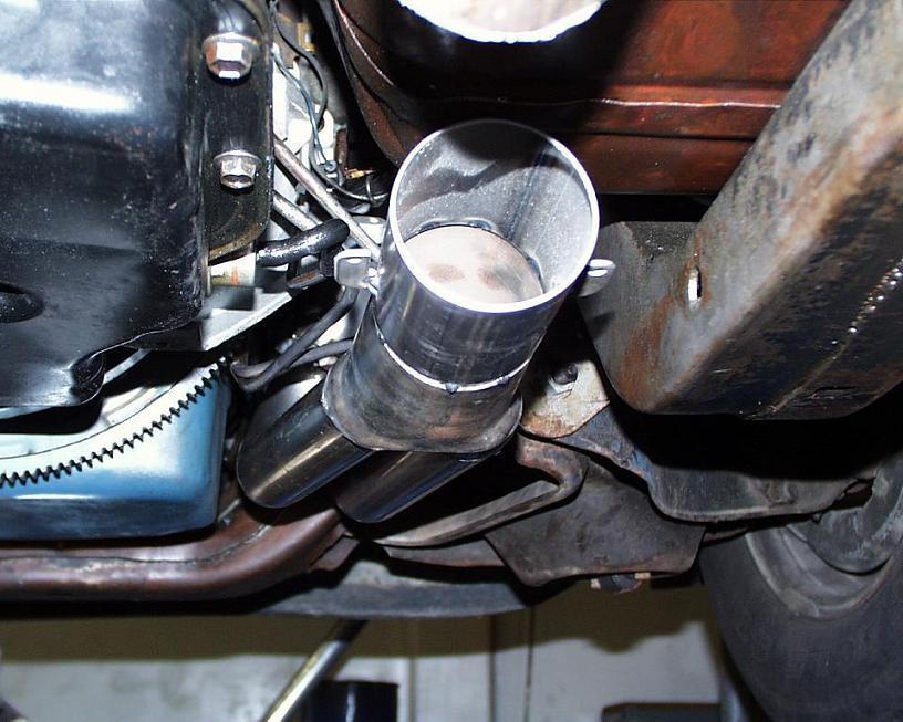

pics

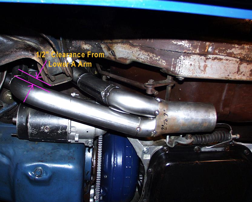

pics.

Good shots of the install. I have a Milodon oil pan that kicks out on both sides and im not sure if the starter is going to interfere with that side of pipes though. I have ram air manifolds now and the starter is 1/8" from the flange because i had to clock the mini starter that much to clear the pan kickout. I'll probably get a set of round ports just to check them out. Have a picture of a 4 speed install and z bar clearance?
