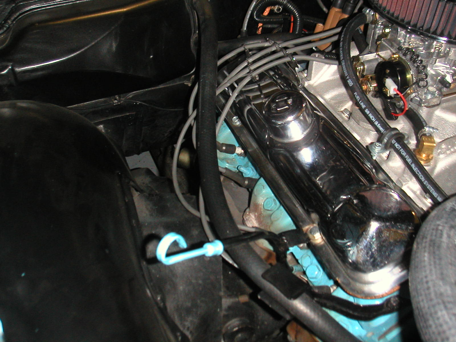

Mine 389 does the same thing but only when the engine gets over about 2500 rpm.. Weird.. I thought it must be vibration. I'll try to turn it around and see if that works. I know the lower tube is in because I put it in and the PVC valve is good.

I to have a 65 389 with the dip stick popping up.All parts of the tube are in place. So your turning the dip stick around, which way are you placing the finger ring? I've tried both ways. Motor was rebuilt in 2000 and has 5000 miles on it now.

Mine is a 1965 389 also rebuilt last September... the DS was popping out all the time until I turned it in this direction... photo attached.

Hey Trips!
I flipped it around and to my surprise it stayed in the tube!
Thanks for the good advice.

You're welcome Thordog but it was actually Mike's idea.....all did was post the photo that showed which direction I turned it. Thanks Mike!! Jim
