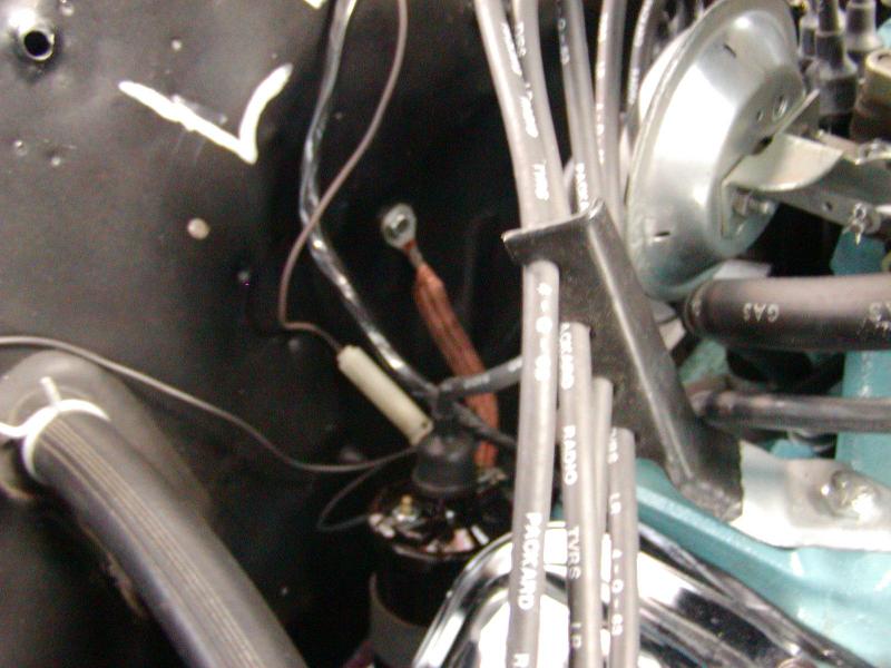

Drivers side

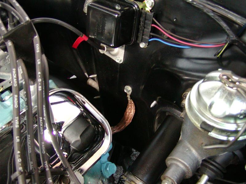

Passenger Side

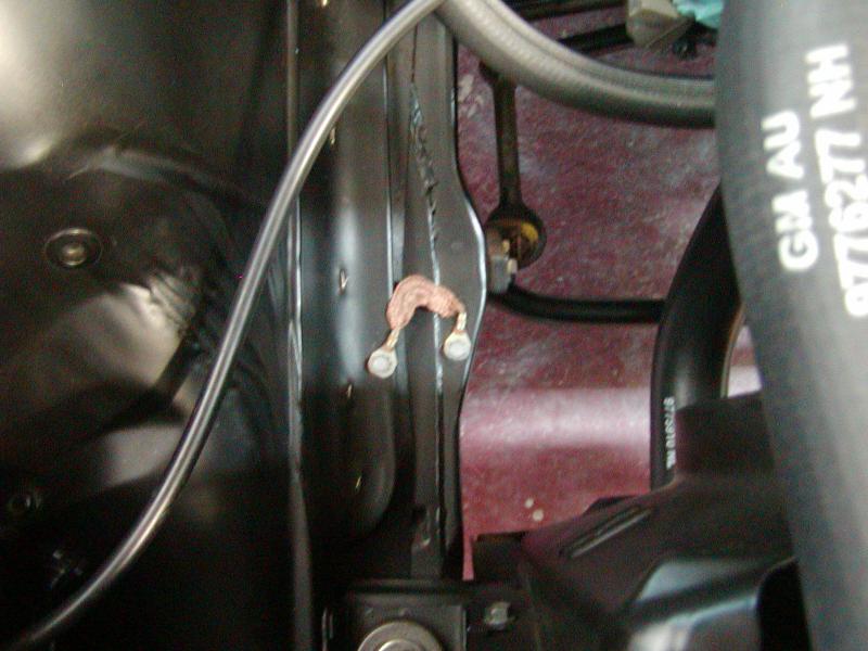

Inner fender to frame
