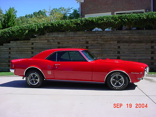

When I got my car, the prior owner already put "stock" springs from Year One. I wanted to lower it just a bit so I had a coil cut and it brought it down a bit too much. (I think the springs were not seated properly in the perches to begin with). Now it's a little bit too low, although it only rubs a little on hard bounces in a turn.
I want to replace the springs and go somewhere in the middle to retain a slight lowered stance with out being too low. It is a 400 a/c car with only the evaporator case. No a/c in the forseable future. Rest of suspension is stock (except swaybars).
I've been considering the Hotchkis but not sure if 2" is too low. Eibach 1" drop concerns me because it is the same part # as SB Chevy and may turn into a 2" drop. Global West's says 1"-2" drop. Same with Performance Suspensions. This seems like a lot of variance.

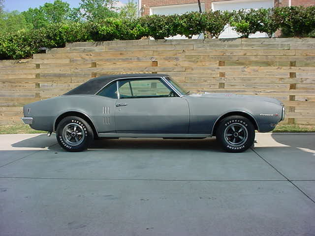

This is after cutting 1 coil off. (and paint)

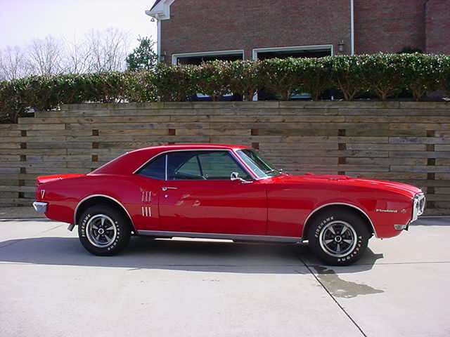

Update to spring replacment:
Decided to go with Hotchkis 2" drop (for pontiac/big block). It brought the car back up to just about to where it was originally. I am a little surprised it was not lower. Haven't had the chance to drive it yet, but it does feel rather firm on the fender bounce.

I have now driven the car a little and everything settled. The height is right where I wanted it, in between the originals and the cut springs pictured above.
There is a "2 finger" gap between the top of the tire and the fender. The ride is firm but not at all harsh.
Overall I am very happy with the results!!

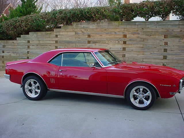

Last update. Put the 17" Torq Thrust on today.
17x7 4.0" back space front w/235/45/17
17x8 4.75" back space rear w/255/45/17
I chose these sizes as they matched overall tire height by .2"-.4" but put a lot more tread down. So far no rubbing issues up front. A lot of room in the rear.
Same "2 finger" space from top of tire to fender i had with the 215/70/14.

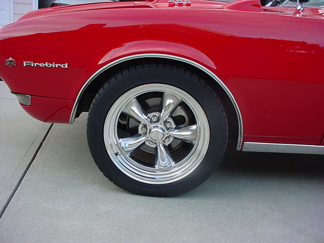

Close up of front tire/fender clearance
