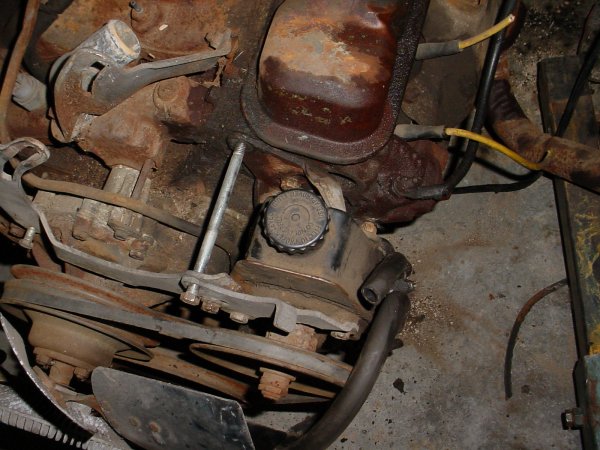

Didn't see that you wanted alternator pictures also, but I can get them. Here is a picture of the front power steering bracket with bolts, washer and spacer.

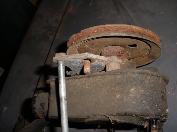

Placed on power steering unit.

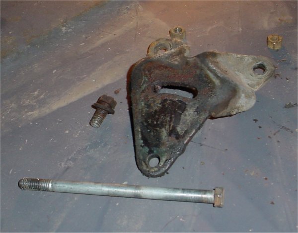

Rear bracket, bolts and washer. If you can notice, it is missing the correct nut and a spacer.

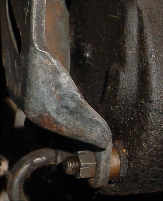

Installed on power steering unit.

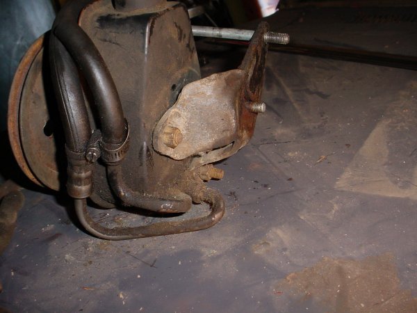

Picture of correct nut and spacer.

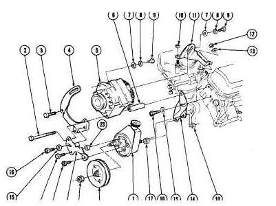

Great pics, Mike.
Here is the illustration from the MPC, just in case you need it.
