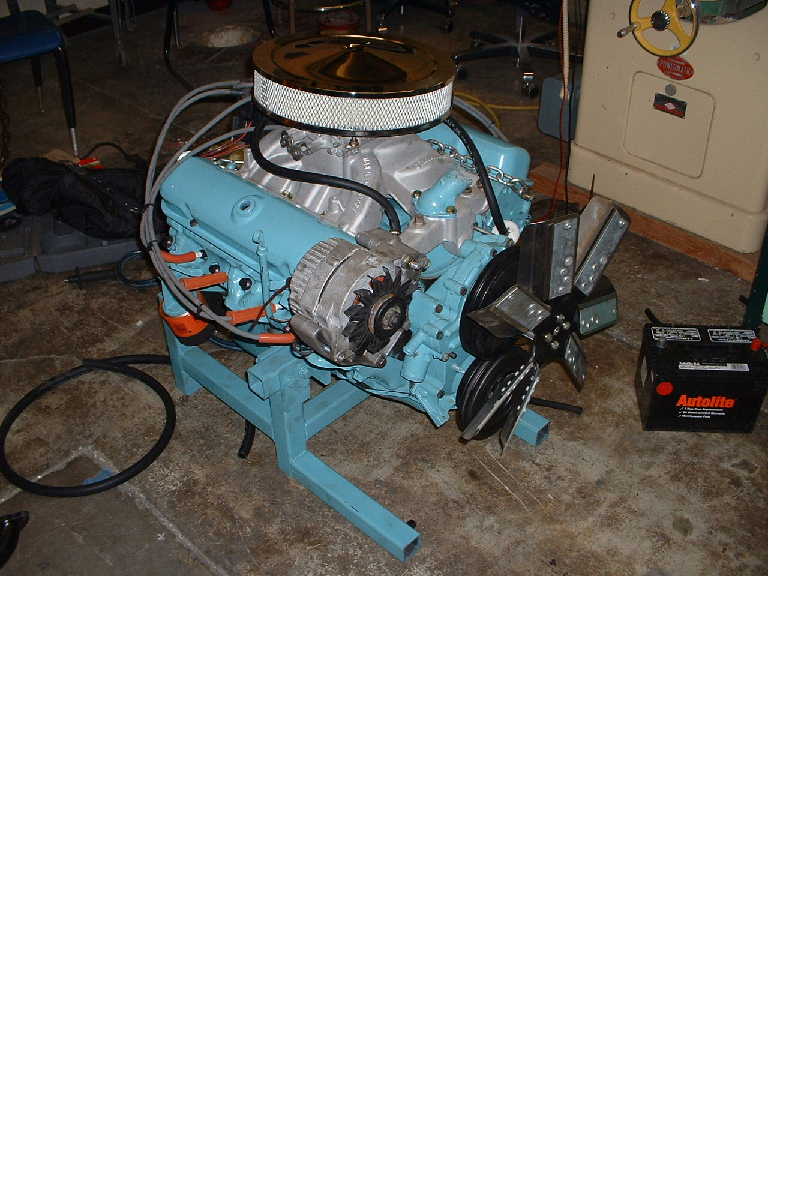

Here is a photo of my 455.

2nd try

You're not planning on teaching some unsuspecting Chevy or Mustang a lesson are you?
Sounds like a good setup to me. Santa has paid you an early visit!
