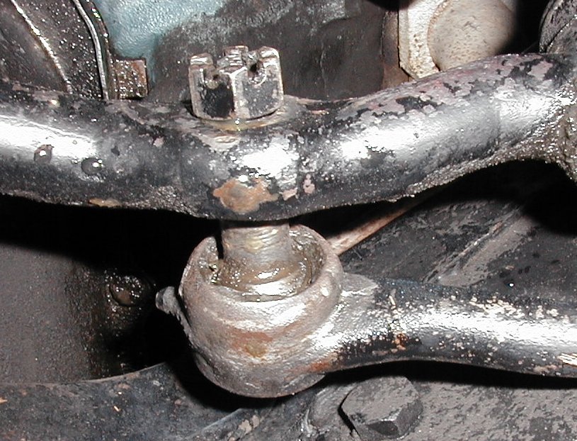

Took the car out the other day and within a couple of blocks noticed my steering got really sloppy, almost an inch of play in the steering wheel. I was still close to home so I nursed it back to the shop. Started poking around the front suspension and found this...
driver's side inner tie rod to center link, no boot, no cotter pin and only about 3 threads holding it together. Good thing I didn't take it out on the highway and romp in it. That could have been really ugly.

Better make sure you take a good look at the center link...
Good chance the tapered hole is getting egg shaped.

I don't know what happened to the cotter pin and boot, they used to be there. Anyway, the nut's cross-threaded onto the tie rod and the center link is definitely shot. I'd been planning on rebuilding the front end, so I've already got just about everything except the center link and inner tie rod ends. Guess I'll be depleting my car fund a little more than expected.
