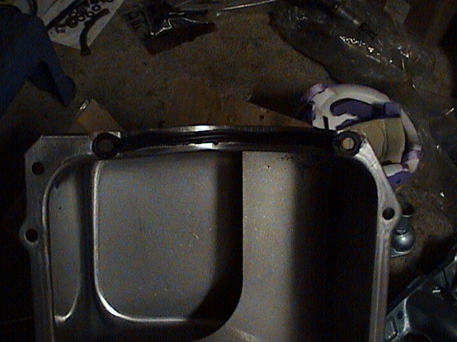

I ordered a gasket kit from PY. They tell me the oil pan gasket does not need sealent.
Does anyone have reconmendations on wether or not to use sealent?
Thanks, Jim

For the rear main cap, PY supplied me with a rubber gasket with spikes on it.
The other 3 gaskets are a composite type material.
It seems to me the rubber gets no sealant and the composite should receive sealant??
If so, sounds like the majority says go with silicone.

In a past issue of High Performance Pontiac there is an article "panning for good seal" that discusses the pros and cons of the rear seal. The best choice is the cork gasket.Oil pan seal
