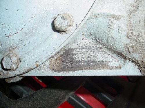

I can't be sure what it is. It's definitely different than the 12 bolt re in my '69 el Camino.
According to the GTO Restoration guide, there should be two letters, not numbers, on the rear of the left axle housing. You can see where I've been scraping paint.
Here's a photo-

To update, I found some raised letters cast into the front side of the diff.
It has the number "16" at about the 10 o'clock position and then at about 8'clock, the numbers "40227". Right at the bottom, ie. 6'oclock, it has the letters "CFD" followed by either an "A" or a delta shaped figure.
Any ideas?

Here is what I have as far as stamping goes...
