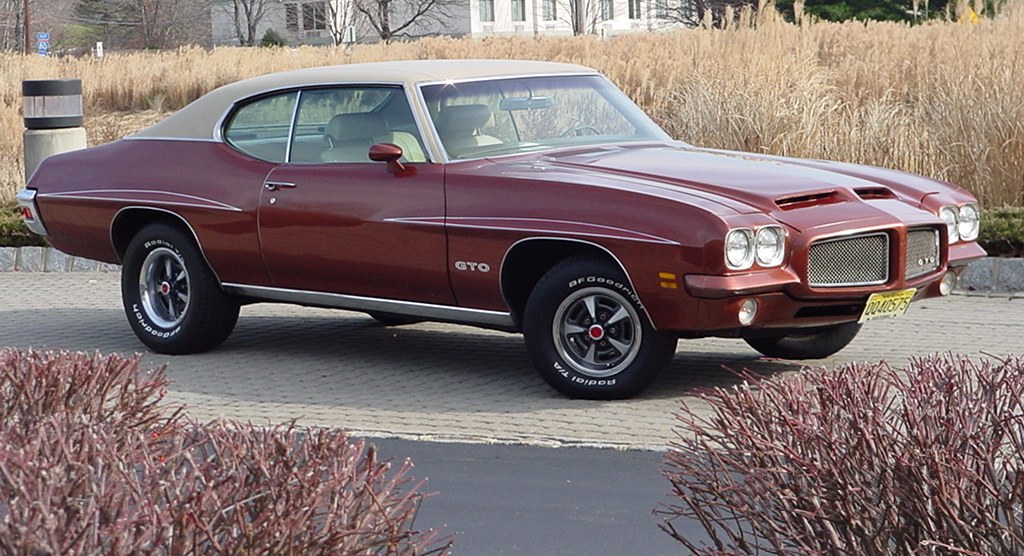

is the stripes your talking about on my car? i believe they are called vinyl sport stripes on my build sheet, and rally stripes on my special order reciept.
if so i want them too cause this is the original paint but im getting it painted soon. ive looked but i can't find them

Yes, they are the optional stripes that could be ordered on any T-37, LeMans, GTO. Dan Jensens car was build in April and the special order stripes were the style you have on the GTO. OPH stated that in 71 1/2 the stripes on the GT-37 became a sword (reflective) stripe. Here is what one looks like. This is John Sawruk's car. It is the same stripe used in '72 on the LeMans GT.

On these Red/White & Red/Black stripe's, are the
two stripe color's touching each other or is there
a sliver of body color showing between them?
It's been a while since I've seen Dan's T-37 up
close,and I can't remember?
Does someone have a digital camera that can take
a close-up pic on one end of a stripe?

they dont touch each other on the front edge the red/white are about 1.25" from each other,on the back edge they are about 2" from each other.the top stripe is 1/8"wide,the bottom stripe is 3/16" wide,the middle stripes are 1/4" wide.
