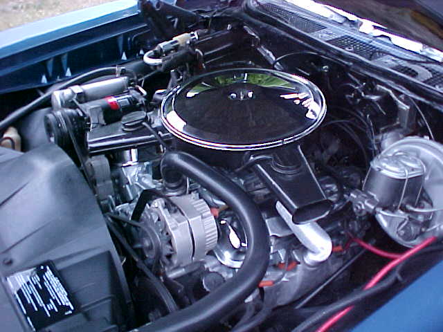

I agree, Dual Snorkel is the best!!

I think the '69 and '70 are slightly different. One of them has a larger angle between the snorkles to accomodate the cruise control unit. Maybe OPH or someone can chime in ...
