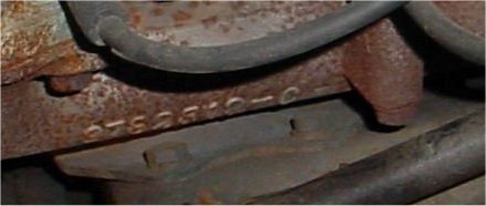

Drivers Side 455 mount. Notice how the mount sits over the frame.
So long, farewell.

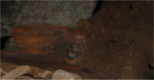

Drivers side 400 mount.
So long, farewell.

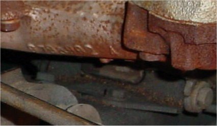

Passengers side 455 mount. Width of frame mount is about 5-1/2".
So long, farewell.

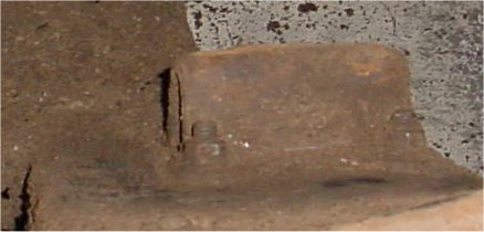

Passengers side 400 mount.
So long, farewell.

Thanks,
the pics are extremely helpful. The owner of this one has been a pain to deal with. going to look at it is not the most enjoyable experience. This will save me alot of time.
