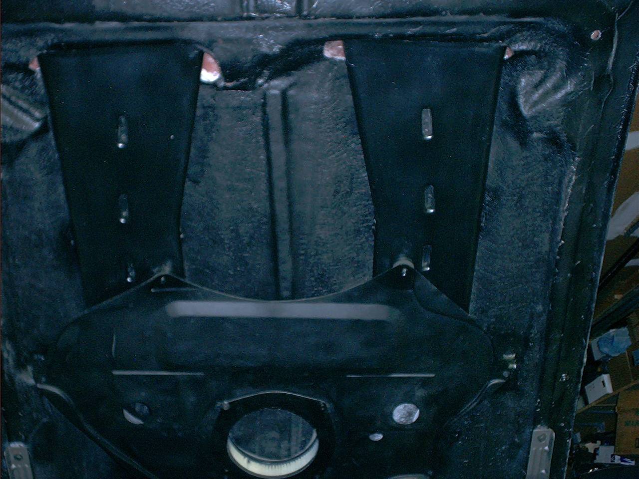

Anybody have a pic of the underside of a fiberglass hood with air tubes? Is there any bracing under there or is it like most aftermarket fiberglass hoods? I have one without the tubes now and am trying to figure out how to make a functional one. I don't want to buy a new one without knowing what it's like. I have e-mailed some companies but have had no responses.

Here ya go. It does not have the heat flapper installed yet but it gives you a close idea. The other glass hoods have the frame under them where the tubes run under but I have heard they do not fit well so I stayed with no frame and glassed in underhood supports to fix the tubes and pan in place. I works like a champ as my TA came sans hood. Still looking for a steel hood.

Bob, to answer your question, most glass hoods use the stock hinges but you cannot use the stock hood springs or latch. The stock springs because the hood to sit up too high as well as stress cracks from opening and closing it. You need the lighter hood springs for this. You also cannot put the RA tubes and pans in most of them unless you do what I did in the earlier post. You also do not have the latch mechanism as it is a molded glass frame so that cannot work in keeping the hood down, so you use hood pins which were a dealer option on the 69 Bird and TA. There is one company called Camaro & Firebird specialties Aurora N.Y. who has glass over steel frame TA hoods. Cost is approx 600 + S&H, but I not sure of the fit on these. They have the stock latch and you can put RA pans and tubes on this one.
